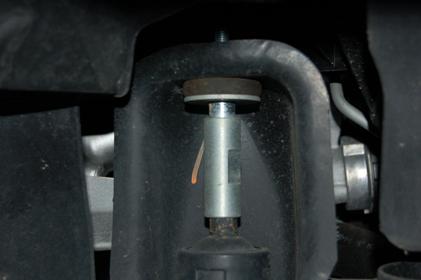

I have to say if i had to do it again, i would just order the 2.5 with the longer shocks. The front shock extension is an aluminum piece that screws onto the factory shock and just seems like a weak point. As for the drive its close to stock, but i feel like aftermarket shocks might have a little more give. Factory shocks seem a little bouncier than before.

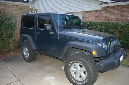

Here ya go....
Lnufnu
