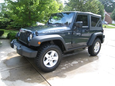

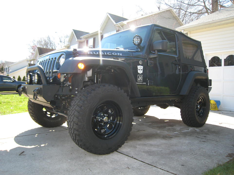

Have had the full flex arm 3 inch kit for about a year now. No other experience for comparison, but have been very happy with the look and performance of the kit on my 2 door.
