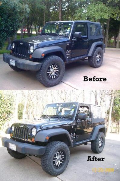

ive had the 2.5 BB for 2 years now, its a solid lift, comes with everything you need, brake line extensions, rear track bar extension, etc.
Not familiar with the shock extensions, i added aftermarket shocks.
I have noticed quite a bit of droop in my front springs from adding a bumper and winch in december. Bump stops are almost touching without flex, so im gonna have to do something about that soon.
Here a before and after for you reference:

im running the 2.5 spacer lift. I bought the one with shock extensions and ended buying aftermarket shocks anyway.
