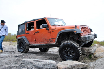

TF 2.5 stuffing 35s with 2" bump stops I believe.

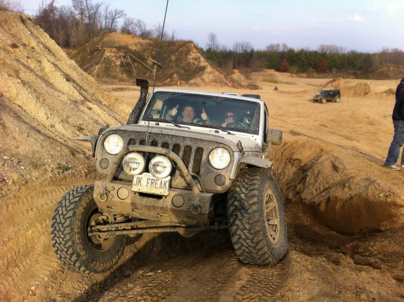

TF 2.5" BB, Cut flares, Bilstein 5100's and 35" Toyo M/T's
