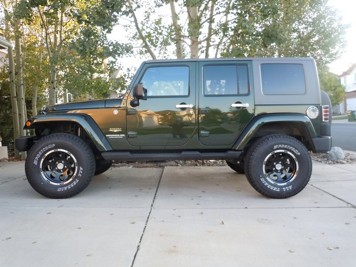

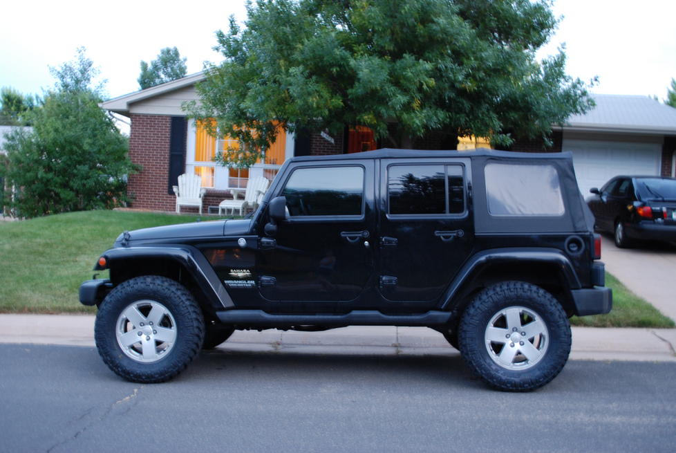

I debated this same thing.. I went with the 2.5 and am plenty happy. I actually went slightly smaller than 35's too as its my DD.. look at my sig below. Basically I have 34.6" x 11.5" vs the 34.8" x 12.5" that "35s" would have been. For me having the smaller width helps with snow and resistance, so I'm happy. personally if I didn't do the 2.5" I would just to at least a 4" if not more, as the 3" is getting you very little. But as someone said above you then have to seriously think about a complete package include -arms and drive shafts. Not in my budget. 35s with stock gears works, but new gears will be in the future year or two, especially here in Colorado as the mountains kill me.
Before
Name:	Jeep Lift__026..jpg
After
Name:	Jeep Lift__047..jpg

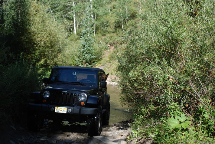

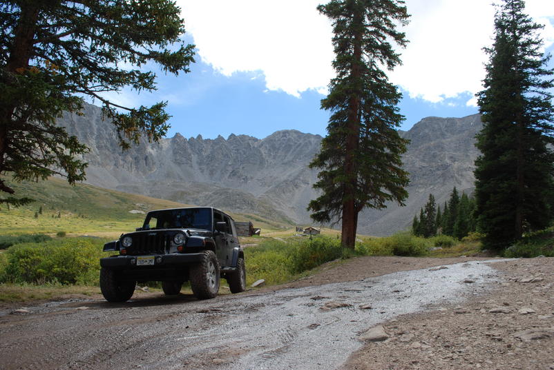

On the trail
Name:	CM Annivt__085..jpg
Name:	CM Annivt__001..jpg

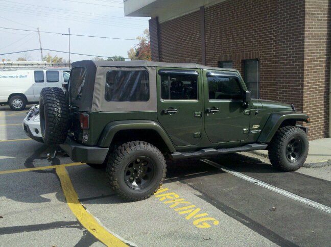

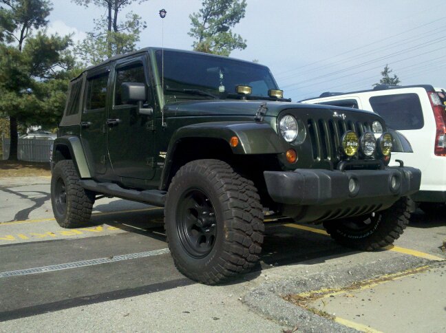

I have the Teraflex 2.5 coil kit on mine and love it. I went with the 33's due to the fact that I like the look of the wheel well better, plus my JK is a daily driver with a lot of expressway driving also. I dont do a lot of offroad so it was the best thing for me.....and I dont regret the 33's either!!! I think the look is great!!
