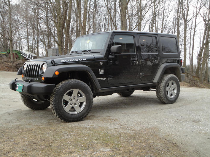

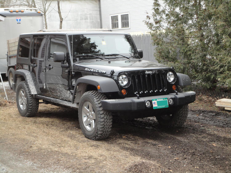

Just a few worked all night installed the lift and now it's crappy out and getting dark

You are gonna need a front driveshaft in a 2012 due to the motor orientation versus the older models. 2012 driveshaft angle is nearly maxed when OEM.
