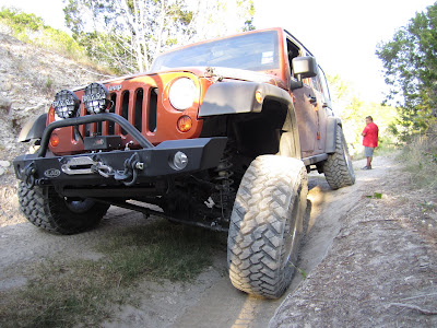

I don't have a rubicon but I have the setup your asking about. I rode for two years with stock shocks with the extenders and I can tell you that it's a MUCH MUCH better ride with the bilstein 5100's. I also started having issues with the wear of my tires twards the end. That's the main reason I went ahead and changed out the shocks.

I have this exact setup and love it. The ride is great, height is perfect for what I want. It drives great on the road, feels great on dirt roads, and wheels well. Very happy.

Guys, first of all thanks for the info, I really appreciate, and great pictures!
