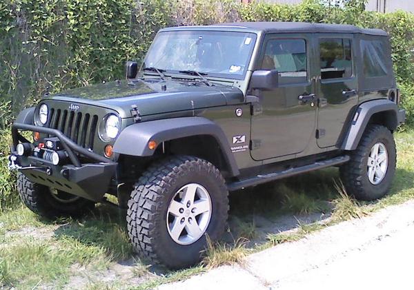

You could check out Northridge 4x4 for a variety of lifts, just tell him your goals. Also on the Tera kits. One of the members here had the 2.5BB and ordered just the frt 3in coils because he had installed a heavy ass bumper and winch. It sits pefectly level now with a BB spacer in the rear and coils up frt.
This is JKrockers rig

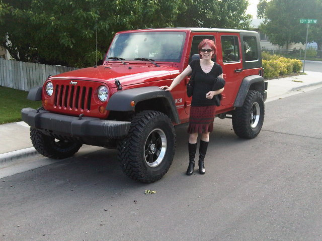

I just installed a TF Budget Boost 2.5 on my wife's new X, and it leveled out the jeep. I was surprised as I was not expecting this, but after the lift and tires went on, it looked pretty good.
