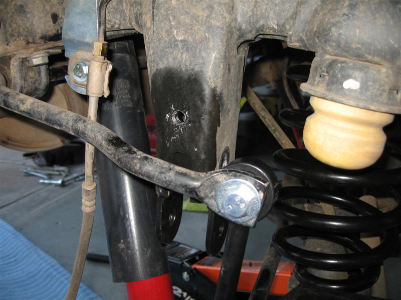

As promised, I am posting up some pics and details of my lift installation and my opinion after running several trails over the weekend. Aside from a few glitches, I'm pretty happy with this setup. I will need a few things to fine tune it, and you can read more on that below. It rides great and has really good flex, especially for using the shock relo brackets.
Measurements: I measured from the ground to the bottom of the back of the front fenders near the front door hinges. On the back, I measured to just in front of the rear fenders behind the back doors. I had a 3/4" Daystar front spacer already on to level the rake. I left this in with the kit to compensate for a future front bumper and winch. For some reason my Jeep leans to the passenger side. Maybe the full tank of gas. Also, I have no front bumper and only the stock plastic rear bumper, cut down to a stubby.
Driver front: 21 1/4" before to 24" after (+2 3/4")
Passenger front: 20 5/8" before to 23 3/8" after (+2 3/4")
Driver rear: 21 7/8" before to 24 1/8" after (+2 1/4")
Passenger rear: 21 1/8" before to 23 1/4" (+2 1/8")
The install was pretty straight forward. The instructions were good. Packaging was good. Shipping and delivery was great, as they rushed it out for me. Unfortunately, in the rush, the rear spring retention clips were overlooked. Joe is shipping those to me now, though.

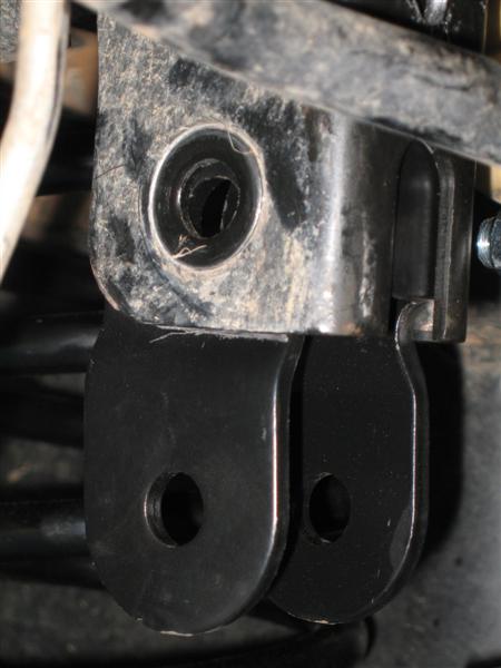

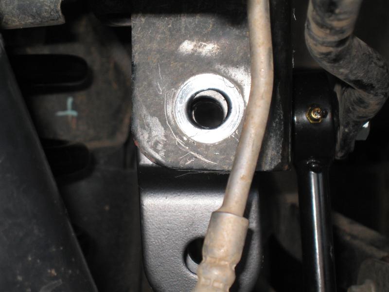

The rear track bar bracket and it's template could be better, but I'm not sure of the fix. I also know that Teraflex offers a diff bracket now, so maybe they have already recognized and addressed this. The hole you drill needs to be right on the money, and the template lays over the existing bracket which has rounded edges. It is easy to be off a few mm, which will make bolting this up difficult. I also found that the new bracket did not slide all the way up inside the old bracket, which made lining up the pre-fabbed holes of the 2 brackets nearly impossible. A pry bar, hammer and ultimately a broken bolt (needing a new one obviously) got it mounted.

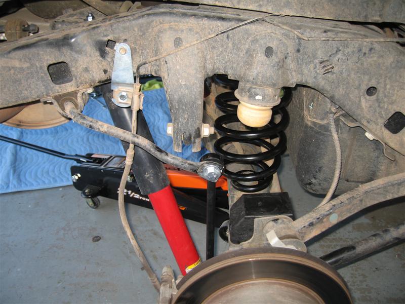

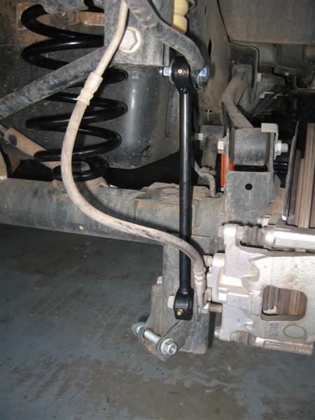

The instructions specifically tell you how to mount the rear sway bar links, and which way to have the bolt heads and the nuts. It states to mount the nuts on the inside of the top to give more clearance from the tire sidewall. This is making the end of the bolt rub on the frame rail just in front of the sway bar bracket at full flex, but just barely. Make sure you bend those brake lines up also. Otherwise, it will make contact and could break the line. My rims are 3.75" back spacing, so clearance to the tire is not an issue. I am going to try to turn these bolts around and see if I solves the problem.
Other than those 2 issues, the rear was good. The shock adapters are beefier than I expected, and I was able to get the coils in without much trouble. The bottom bump stops look like they are in backwards as far as visually lining up where you would expect them to hit when fully compressed. However, at full stuff, they do hit right in the middle of the bottom brackets.

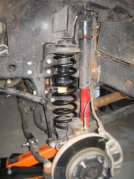

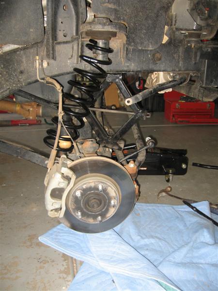

The front was easier than the rear, with the exception of squeezing in the new springs without a coil compressor. The extended bump stops are a little challenging to pop in, but not that big of a deal. I did find that I had a little more room to stuff the springs up there without the bump stops installed. I set them inside the spring while I wrangled it into place and then used a pry bar to push the bump stop into place afterward.

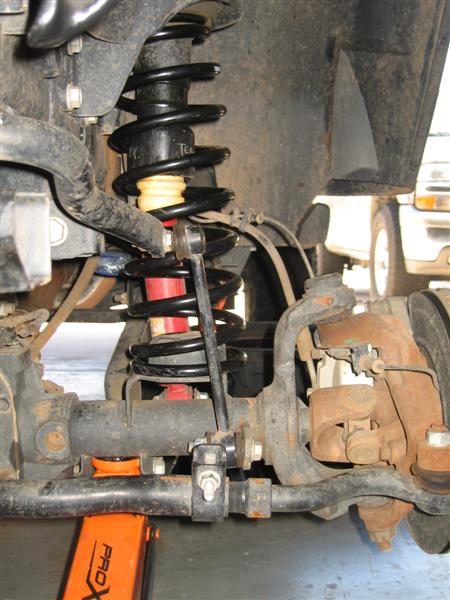

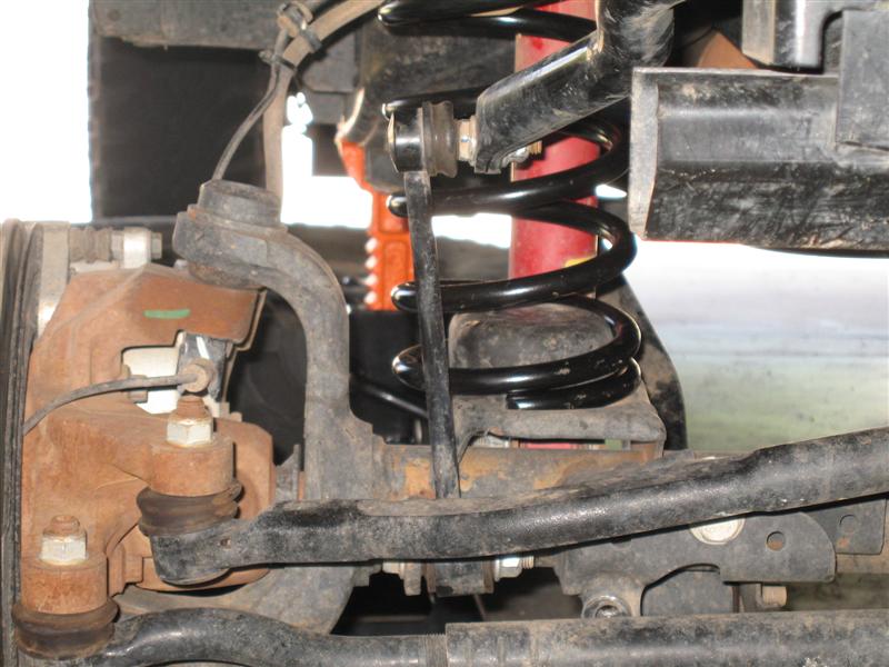

Now my biggest concern is the front sway bar and extensions. Of course, you use the rears to relocate to the front and that seems to make sense. Keep in mind that I ALSO have an additional 3/4" spacer above the coils. My axle shifted about an inch to the driver side. This kit does not come with a front track bar relo bracket or bar. I'm not sure what ramifications this will have, but I will HAVE to fix this. The biggest issue I saw with this during the install was mounting up the rear sway bar extensions to the front. Obviously they did not line up with the bar on the top and the bracket on the bottom. I had to put them on, and then just wrench them over with the nuts. I even swapped the location/order of the bolts and ends. I guess I will have to get an adjustable track bar or bracket to move the axle over so there is no binding.
This is the driver side and much more extreme. You can see the angle it sits at and I'm worried about the lower bushing since the shaft does not go straight through it:
The passenger side is not AS bad and changing the order of the bracket/mount/nut helped but I still dont like this angle:

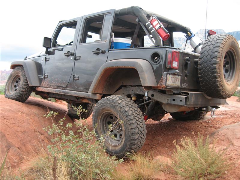

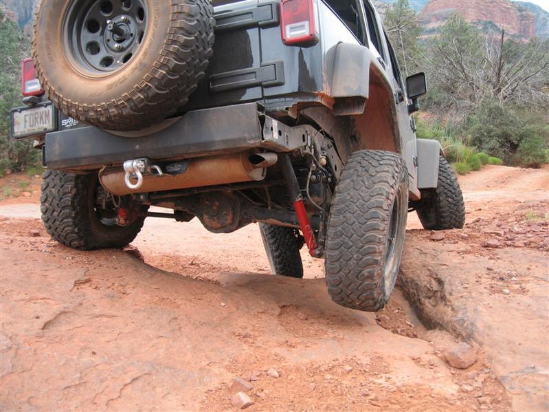

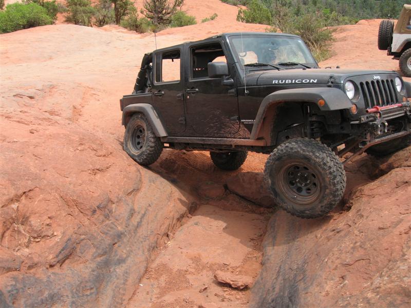

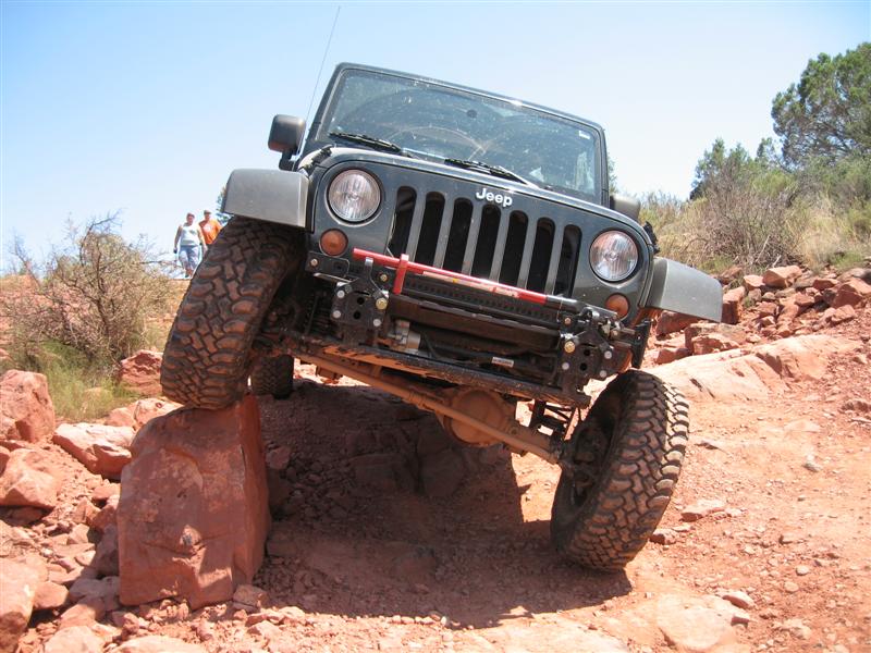

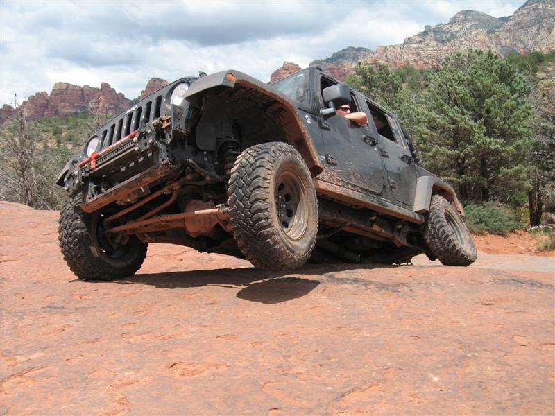

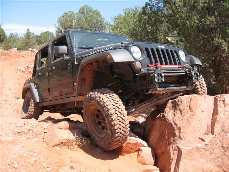

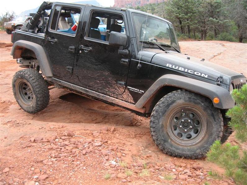

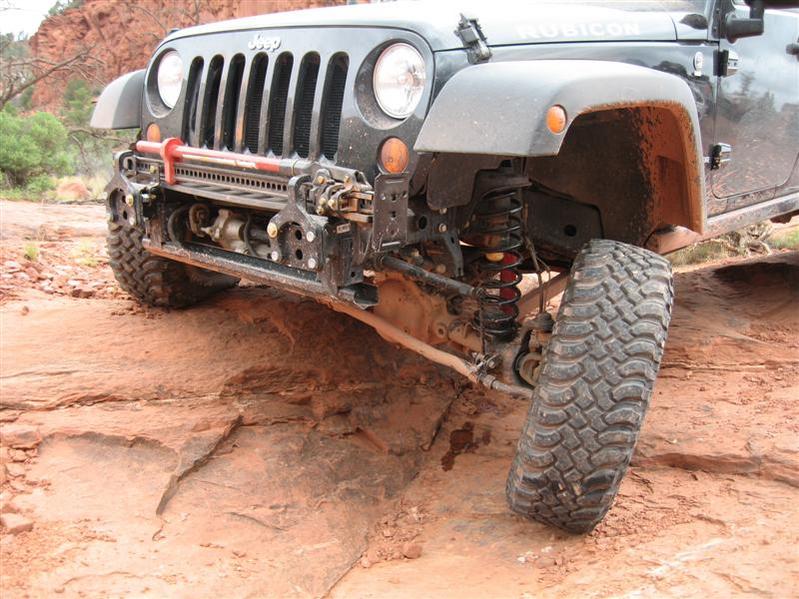

So, since the install, I have done many miles around town, a couple hundred on the the highway up to speeds of 80, and a variety of trails. The ride is fantastic. It has a little more body roll and is a little springy compared to stock. Keep in mind that I have a Rubicon and stock was pretty stiff. I like this setup and ride much better. Even with the sway bar still connected it flexes and reaches into ruts. Driving around town is nice. It wanders ever so slightly, but isnt bad at all. I will have the alignment done, but I think its pretty good.
Disconnected on the trail it was tough to get a tire to lift and also to compress... but I managed! It has good travel and I can only imagine how much better it would be with longer shocks. The tires stayed on the ground and didnt skip or bounce. It didnt creek or bind, and everything operated smoothly. I had no issues with springs popping out, even without the rear spring retention clips. It is solid and performed very well. I would recommend this to anybody.
