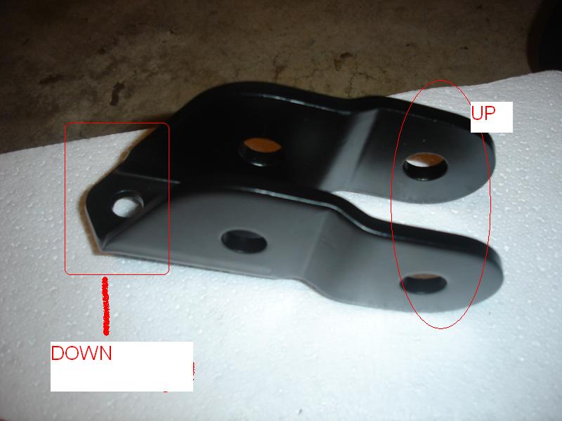

If I had to guess. I would try it like this

It is almost identical to the BDS bracket....so here you go..
This kit is a rather simple install requiring a few tools. Wrenches, drill, drill bits, torque wrench, etc. Begin by raising the Jeep and supporting it on jack stands. Remove the passenger side wheel and unbolt the frame mount side of the track bar. GENTLY rocking the Jeep side to side is usually helpful in removing the track bar bolt.
Using a center punch, mark a drill point for the top hole in the mount. Drill a smaller pilot hole then drill a 1/2" hole. Apply some paint to the hole to prevent rust.
Install the drop bracket. Use the oem bolt and nut in the upper mount hole, torque to 110 ft-lbs. Install the 1" 7/16 bolt and washer into the lower bracket hole. Install the 1 1/4" 7/16 bolt and nut into the upper hole, tighten to 45 ft-lbs.
Raise the track bar, it will probably be necessary to push the Jeep to the left to allow the bolt to line up. This is the difference the mount makes. Torque the 14mm bolt to 110 ft-lbs.
These are from ny BDS bracket instructions but they look identical except for the paint.
Here is a BDS bracket..
Hope this helps...

That looks familiar, different color, but quite similar to BDS bracket:
BaltChief beat me to it, but, it does go on the frame side. The other post above has it backwards, the rounded side goes down, not up. Since it is so similar to the BDS bracket, I will layout how I put that one on - it fits inside the stock bracket, you will be able to tell that once you remove the track bar. The larger, rounded end goes down, and the open side of the bracket goes on the inside. I had to drill a hole in the stock bracket for the topmost hole in the BDS bracket, as a bolt and nut are provided to mount there. The stock track bar bolt goes through the middle holes to mount the aftermarket bracket. Tera should have sent a new bolt for mounting the track bar to the new bracket. I hope this makes sense. I probably can find the BDS instructions and scan them if you want...

Well I guess it was my turn to learn something new today. I would of installed it upside down. SO the I guess the BDS is a good substitue for the TF? Also is this really needed?
