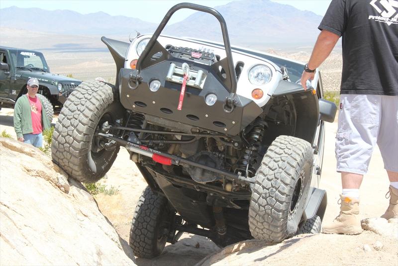

ID:	159775Click image for larger version
ID:	159776We have the teraflex 3" lift with adj. control arms upper and lower. And both front and rear teraflex adj. trackbars. This lift is awesome our jeep rides better than stock and steers like a bullet. We have had this lift on our jeep for about 6 months with no problems. I had to make the same choice . After contacting teraflex direct and also talking to some alignment guys. I went 3" fully adjustable. It is more expensive now but you won't have any of the alignment issues other guys are having. We have no high speed wobbles or vibrations. I believe I will save money in the long run with proper tire ware. Tires are expensive.

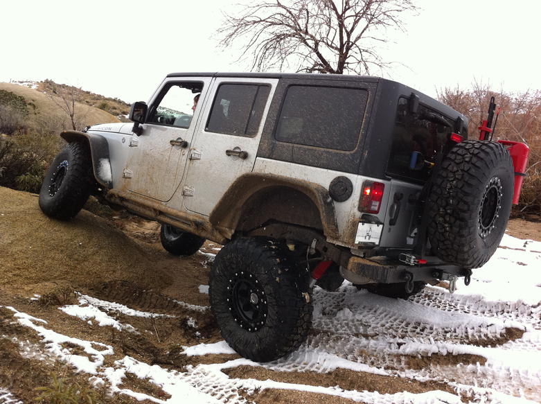

ID:	159793Click image for larger version
