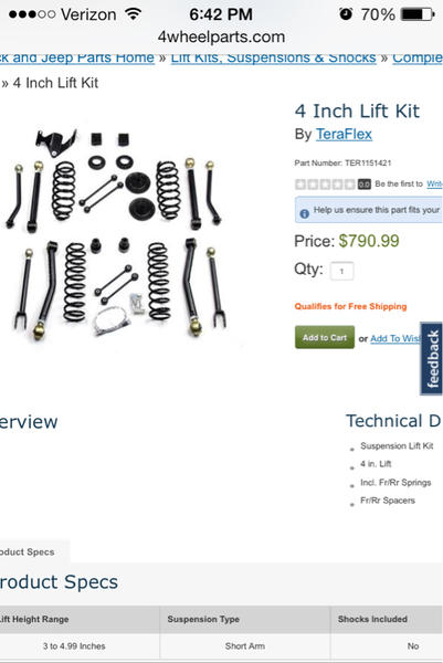

Has anybody heard anything good or bad about this lift? I'm looking for something I can get good flex with but still b somewhat stable on the highway.

Either the picture or the price is wrong. (yeah, the pic is a $2000+ lift)
Teraflex has a good rep, and you can contact them on this forum for more info.
Be sure to factor in the other components you will probably want for a 4" lift. (, front trackbar, draglink flip, driveshaft, whatever else)

Looks like that vendor is showing the pic of the higher end 4" kit but are really trying to sell you our basic kit. The part #1151421 is just basic 4" kit that has no control arms/front trackbar/shocks with it. The actual kit in the picture is a 3" 8-Flex-Arm kit with no shocks.
Watch out what you actually get in a kit from a vendor. Go by the part number and not the pic.
