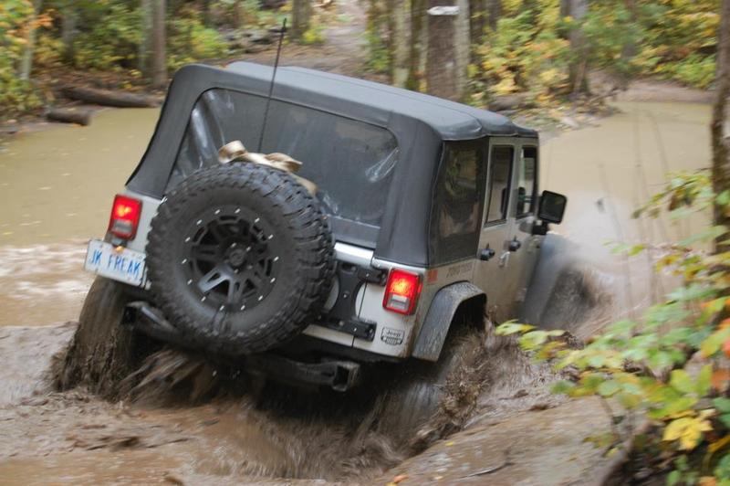

Originally Posted by hollywd32
What about those who have the rugged ridge 17 rims with 4.67 back spacing? Spacer or no? Have the teraflex kit but havent had the time or decent weather.
Thanks
Teraflex hinged carrier with stock tire mount and Rugged Ridge Wheels...fits perfect!
