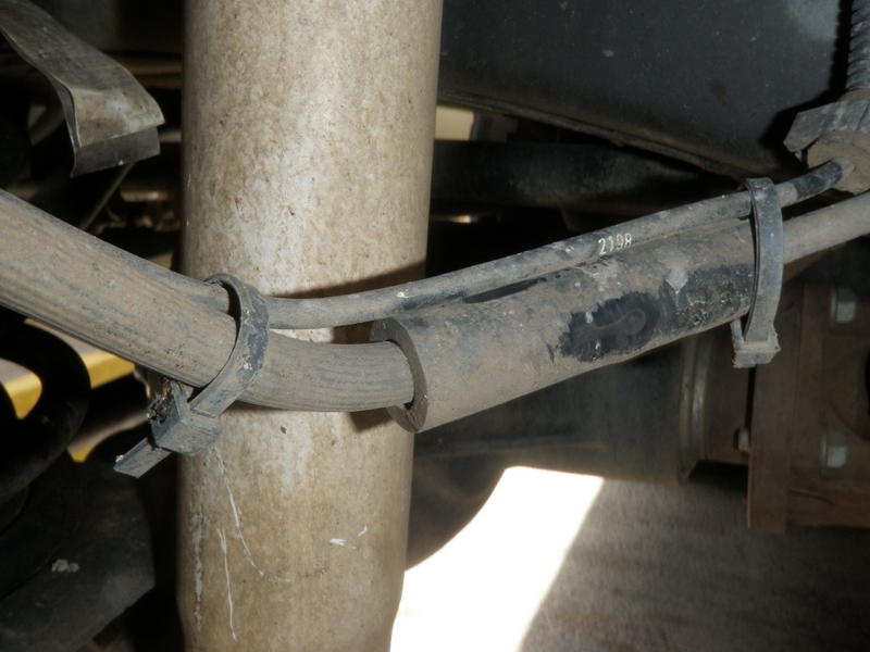

Stock rims do rub. I installed the 2.5" BB and my stock tires (255/70/18) started rubbing. Frnt tires at full turn rub slightly with brake line componets, and rear sway bae will sometimes hit the tires. Terraflex sponsor on the forum did clarify that 1.25 spacers are needed. Installed my spacers and no more rubbing. Other non-stock wheels do not rub, just the stock wheels.

Old Dec 20, 2010 | 10:09 AM
rickster's Avatar
Joined: Feb 2010
Posts: 347
From: Puerto Rico
Originally Posted by Dozerdriver
I think it's weird that some rub and some don't... I would say try without the spacers and see if your does or not.
Here's rubbing in the front wheels at full turn:
The rear sawy bar was correctly centered, as I found "clean" spots at both sides.
No more rubbing after Terra's 1.25 spacers.
