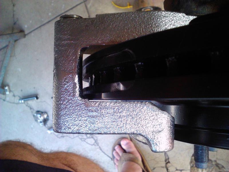

well the title says it all. I Need help with a teraflex big brake kit (the basic on with rotors and caliper brackets) I ordered one through quadratec received it started to install it and there was .019" clearance between the caliper brackets with those little clips installed and the rotor. I was using 2 lug nuts to hold the rotors on so they should have been tight to the axle.
I called teraflex and they sent me new rotors the new rotors had around .03X" clearance between the rotors and brackets WITHOUT the clips installed. I called back they sent me new brackets the new brackets have .032" and .029" without those clips installed. So now I need help. what is wrong here. Im hoping teraflex will chime in here and help me out

I guessing from your pics that the caliper mounting bracket is not centered over the rotor? I don't know about the teraflex kit but other kits that I've seen use shims between the caliper bracket and the mounting surface to center the caliper. I guess teraflex is having quality control issues again.
Sent from my iPhone using Tapatalk . Rich
no shims came with the original kit and no mention of shims was in the instructions. when I called the first time I was told "we had a bad run of calipers and brackets" but what are the odds of me getting 2 sets of rotors and brackets that are bad. I literally have 4 rotors and 4 brackets on my shelf right now and all of them spec out within a few thousands of each other
