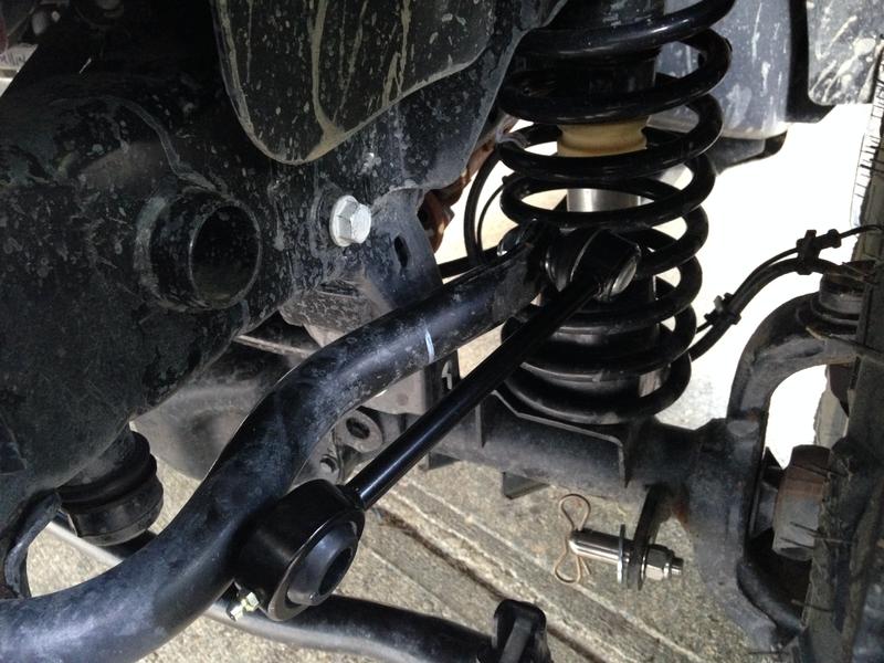

OK, so the disconnects are now installed, and i'm using them at the moment with out the stowing bracket.
Out with the old:
In with the new:

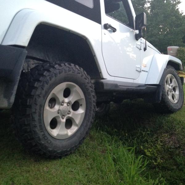

So I played around with it last night in a ditch. I noticed a slight rub at full lock and flexing. (this photo wasn't taken at the point I noticed the rub, just thought that those of you with A.D.D. like myself would appreciate the pictures.
Name:	photo 2 (2).jpg
So my train of thought is to put a couple 3/8 washers behind the steering stop, and that MIGHT solve the issue all together, and may even allow me to use the stowing bracket. Here's the thing, the sway bar disconnect and sway bar itself do not have any sharp edges and such that could puncture a sidewall, at least it doesn't look that way. Look at the above picture for reference. It seems with the newer model of this product they identified the issue and smoothed out the lines. And note that when it rubbed last night, the sway bar and connect was bungeed as seen in the picture in the correct position, parallel. What are your thoughts ladies and gents?
