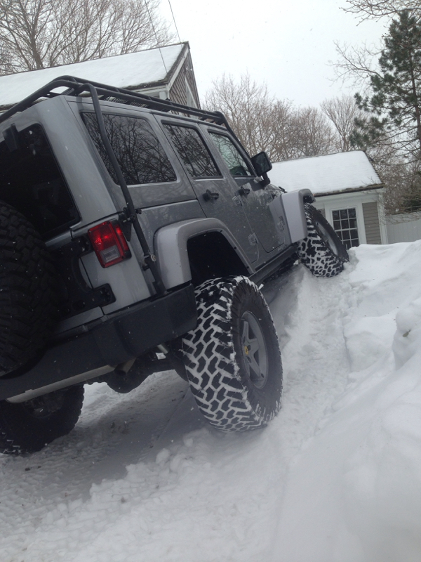

The Teraflex tire carrier works perfect. I don't know why everyone who has 35" or bigger tires doesn't have one. I have had mine for over a year with a 37" Nitto Trail Grappler mounted to it. Not a rattle, squeak or even the slightest wiggle and I use my Jeep in all conditions. It takes all of the weight off of the gate. Perfect design in my opinion!

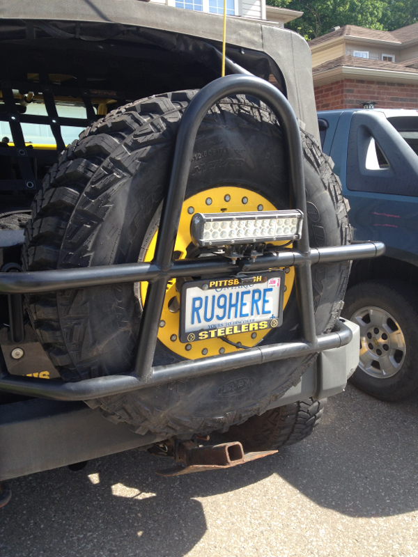

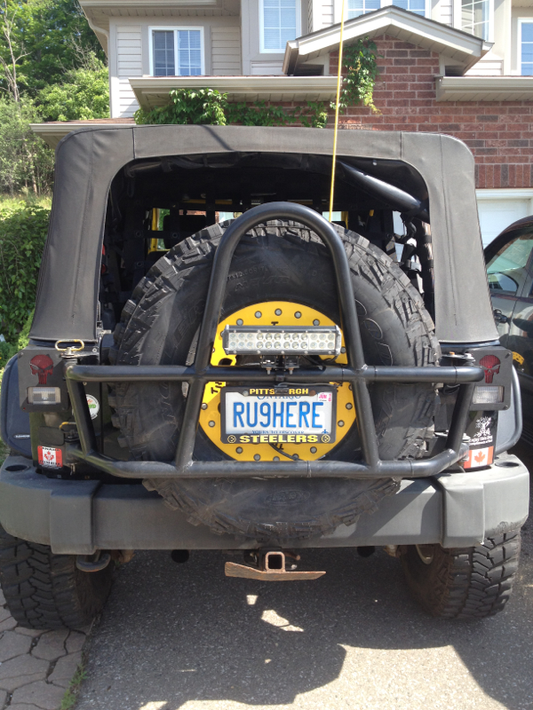

True and maybe because every other week guys were selling theirs out here(might just be the older models where the welds were F'n cracking).
People prefer different looks too for their 35 and 37" tires..... Maybe it works for some and their jeeps and that's fine but I prefer a different look myself. Love my Genright
