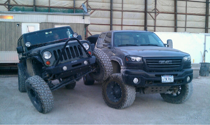

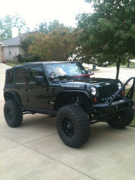

I have same lift without good lift & tools it would be almost impossible. It involved cutting & welding and that's not something I would want to do on my back. Also had to modify exhaust depending on year. So I took mine to professionals
