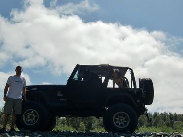

well for the install theres not much of a difference between the budget boost and leveling kit. i installed mine and it took a little less then an hour and that was doing it by myself. but the jeep was only a week old so everything came apart very easy.

this is with my yj when it was on 35s
