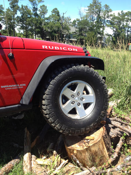

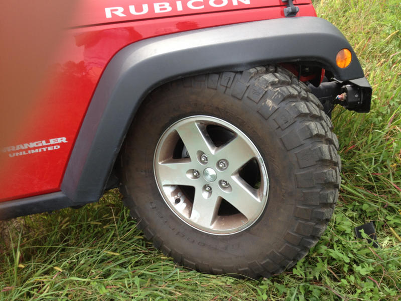

I have 35x12.50sR17 on stock Moab wheels and the TF spring leveling kit. It works great on the highway and light/moderate off roading. I did have some rubbing when disconnected so I trimmed the fenders and pinch seam. I still have a slight rub on the right rear at full stuff.
Do you know if the spring kit is the same as spacers? Obviously it's different in the way it lifts, but does it lift the same height? Like could I run your set up but with the spacer leveling kit?
Same height spacer or springs.
