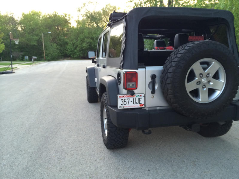

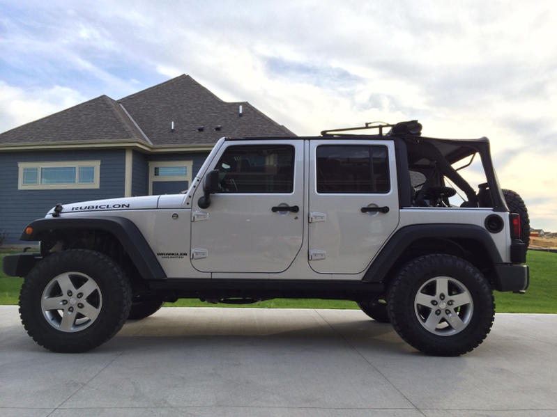

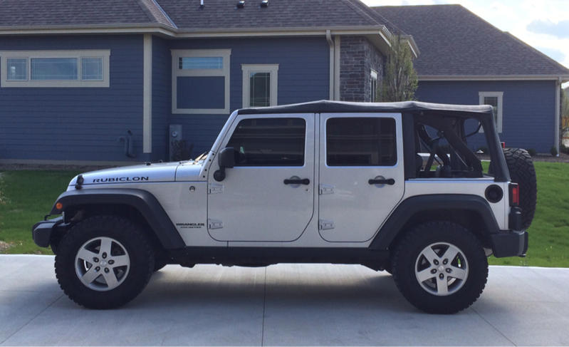

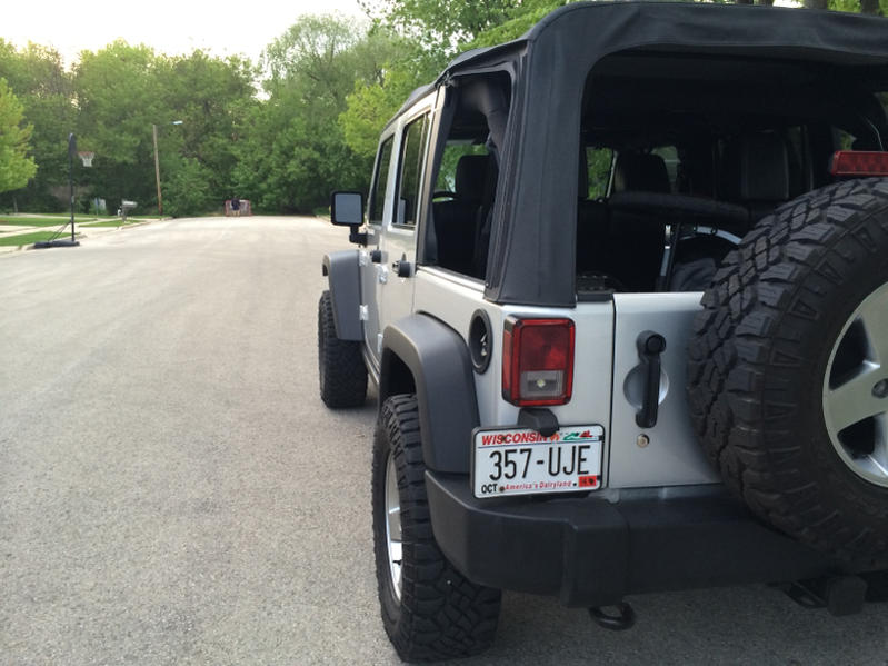

Installed the Teraflex Performance Leveling Kit and Spidertrax Spacers Friday night. Looks and handles great.
Couple questions. We didn't loosen the front track bar, didn't seem necessary to remove as the directions suggested. We got plenty of travel from the front axle. I am thinking I should loosen, shake the Jeep around and re-torque, just be on the safe side. Am I ok, or should I do?
The other question is the sway bar links on the front seem to have threaded holes to grease, but no fitting to screw in. They are already greased as I can see it. Do these need to be plugged. Directions say nothing about greasing or plugging.
Last question, I am pulling left. Need to adjust the steering wheel a bit, but do I need and alignment? Or will shifting the steering wheel fix it?
Before and after pictures below.
