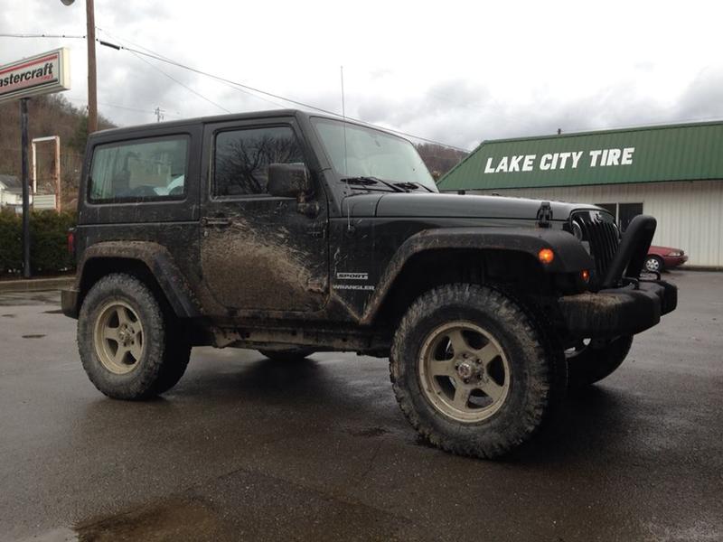

I ordered the leveling kit from teraflex that comes with 2" spacers in the front with exted sway bar link and a 1" spacer and put it on about a month ago and just now had the chance to get out and do some trail riding. Im also running a 285 75 17 which comes out to right at 34" high and 11.5 wide. Thought the jeep did great till I came do a section of the trail that was washed out and off camber. The sound rubbin plastic was so bad I thought it was gonna tear off a fender. So I went home and did some research and the kit said it could clear up to a 35" tire. So ticked off me gets ahold of teraflex and speaks to management and surprisingly they said they would send me the the kit I would need which is the 2.5 bb instead of the leveling kit. The main difference is the 2.5 kit comes with bump stops and instead of a 1" spacer you get I think at 2" spacer in the rear. To my surprise they said they would buy back the lift I had already installed and ran for two months if I would pay the difference from the new lift (disscounted of course). So come next week ill spend a good solid day in the garage redoing this. The thing thats irratating the most is the site said it would clear my tire size and now have to go through alot of trouble and money aligning again. But I am glad the company diddnt just say tuff shit and tell me to go pack sand, lol. so hats off to teraflex. Have a look at the pic and see what you think about the gaps. Its with the leveling kit.

so you are mad because 35's rub without flat fenders or trimming on a leveling kit?

"Clearing" means you can drive with that size tire. Flexing and articulation is a different story.

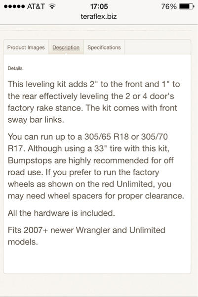

Here's what it says right on there site. Actually says bumpstops are recommended for off-roading with bigger than 33s. A lot of people forget about the responsibility of the consumer.

Dang fellas dont jump to bein so deffensive so quick. They changed the article on there site as I called them about the issue. Its only read that way for 1 day. When I was on the phone with them they read it with me and I screen shoted it and printed it incase they tried to do this. I wasnt mad at all because I did do my home work and called teraflex before I ordered and they said I should have no problem running 34'' tires with the leveing kit "as long as I dont disconnect". Im sorry "this shit piss you off" but thanks for being so persuasive for my thoughts as a newer member for further posts.

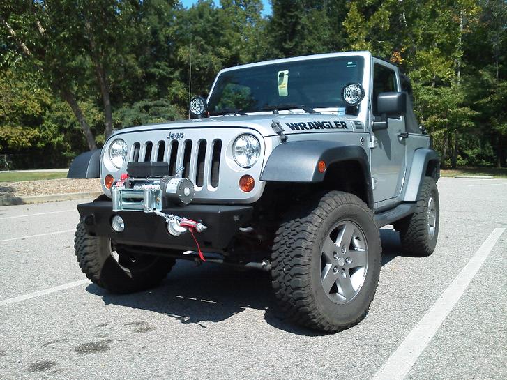

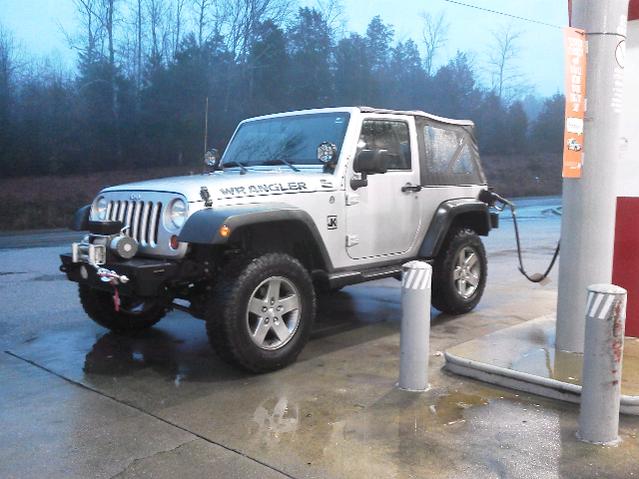

Love to see them. Here is how mine sits at the moment.
ID:	523803Click image for larger version
With wheel spacers and 255's.
