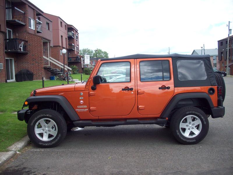

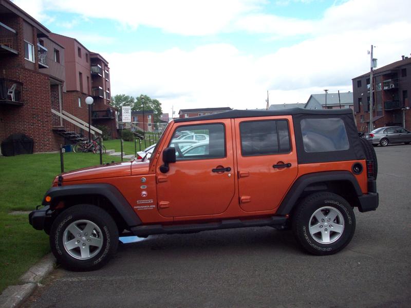

no problems at all you can install it in two hours Click image for larger version
