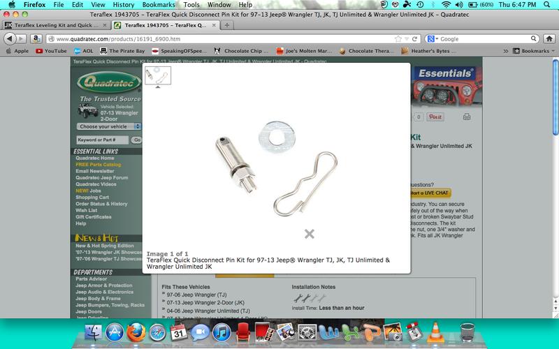

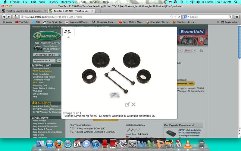

I recently put on a TF Leveling Kit and see that the sway bar links where included. Has anyone had any experience with using the Teraflex Quick Disco Pins in these sway bar links? See pics below.Click image for larger version

If it works it could be a great workaround and save me some $$$, if not I'm probably going down the JKS Quick Disco route.

I used the discos from the kit...less than year later, the bushings were gone. Gone like nit there because they broke apart. I bought a set of jks discos. Greasable and adjustable. Worth the money.

Thanks definitely helps, leaning toward jks but tf pins easy fix instead of taking out stock bolts each time I go off road.
