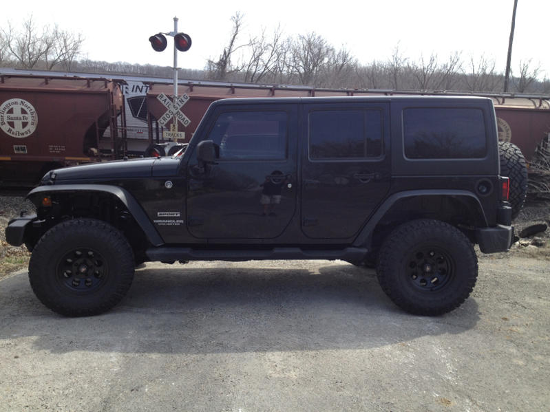

Old Apr 10, 2013 | 03:58 PM
Boverton's Avatar
Posts: 30
From: Kansas
I went with spacer and the Teraflex leveling kit because I did not want to invest a lot of money right now. My 33's turned out nice but I also trimmed my fenders. I want a new highrock stub bumper now and might wish went with new springs. Oh well.
