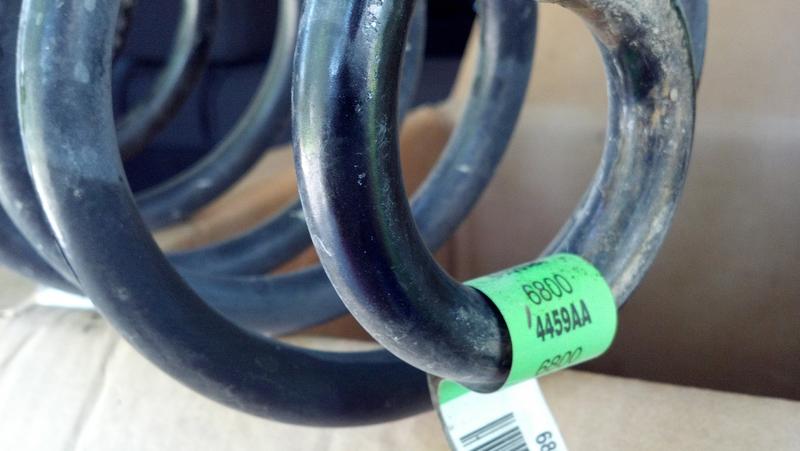

Sapper12b's Avatar
Posts: 2,908
From: Houston, Texas
You want the springs numbers to look like this
