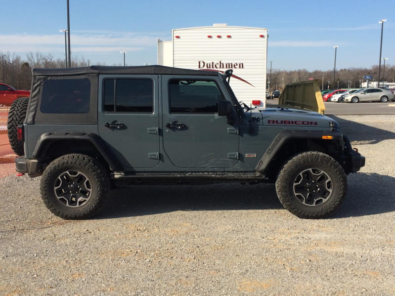

You should be fine got that kit on my 10th with a warn 9.5 cti with no sag no additional spacer needed
