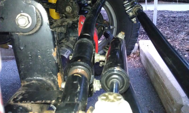

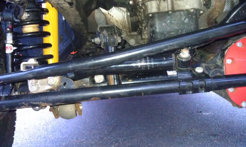

Yeah, I suppose pictures would help wouldn't they! Just went and snapped a few, tried to get a few different angles
so first, from the front
looking at it from the passenger side
and from right under it. you can see in this picture, because of how close the track bar is to the frame that I can't really pick what side the bolts go on, when I had it on the first time, the bolt was actually hitting the frame, I had to twist it. I also noticed a scratch on the steering stabilizer, I'm assuming from the bolt on the track bar

Originally Posted by H.I.I.K
Oh hey why not flip the bolt so that the nut is on the other side?
I had tried that before, you can see on the picture from the side, the big scratch on the frame. That's why I'm thinking of just shortening the bolts

Sneck,
I am running the monster tb, woods relocation bracket, and the stock stabilizer. I had to center the turnbuckle on the upper control arm bracket. I then pointed the turnbuckle opening towards 5 oclock if you are looking at it from the drivers side. I initially had it positioned like you do and put a nice gouge in my ss. I haven't taken it off road since I put the tb on though. So for daily driving, this works.
