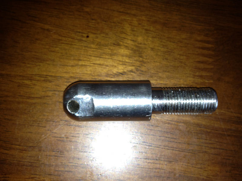

These studs are tight! Hope they go good for some machined down ones. First time trying to disconnect. What a PITA! Teraflex help!!!!!
Had to disconnect with pry bar , hammer , wrenches , etc. definitely what I was not planning on the trail. Arrrrrrgh!
