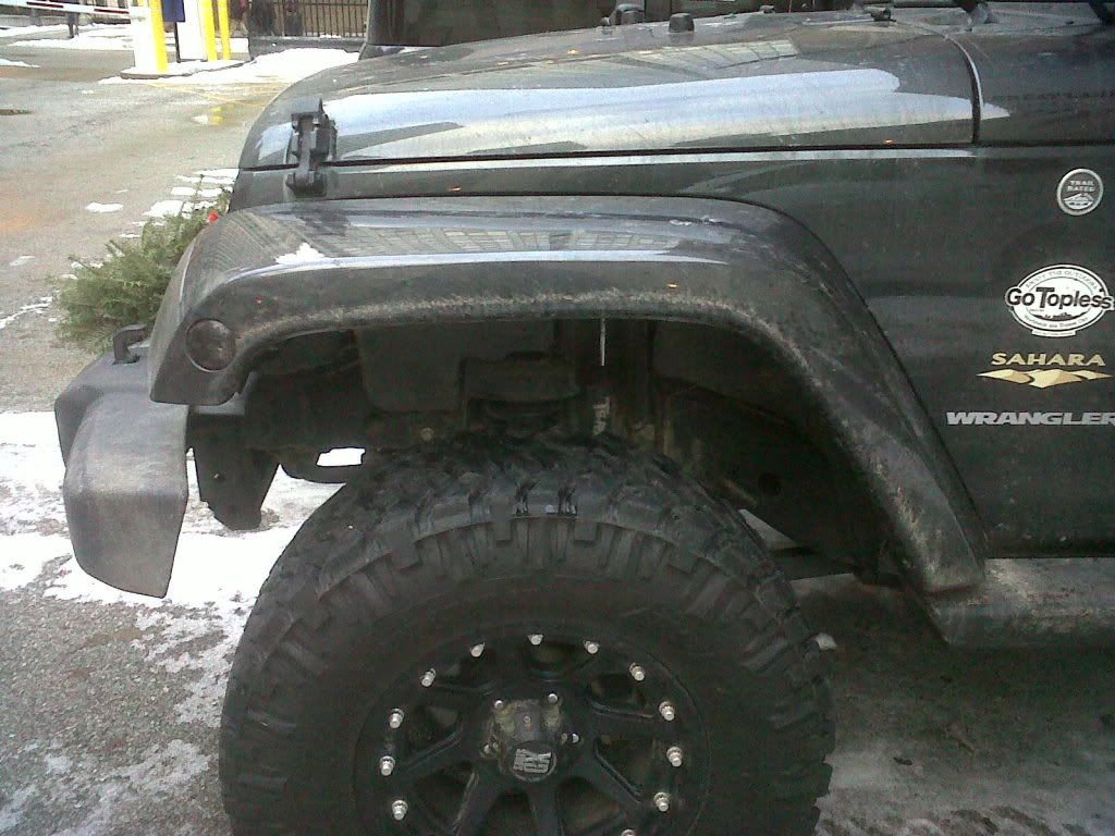

No i got the kit with the 2.5 inch coils and shocks....after putting on the or-fab tire carrier and with the Jerry can and high lift jack with the 33" Nitto trail grappler and XD addict rim on the back it squatted Alot! before adding the tire carrier it was sitting level... Here are some pictures to show you the difference...
I know its on a small hill but it was sitting just about level that is what it looks like right now the rear is that low!!!

I will have pictures soon here to show you the difference uploading them right now!
Old Dec 22, 2010 | 01:07 PM
WillyWonka10's Avatar
Joined: Nov 2009
Posts: 1,050
From: Sugar Grove IL
Rear driver
Front driver
Front Left
Driver Side
without first front driver
without fist driver rear
