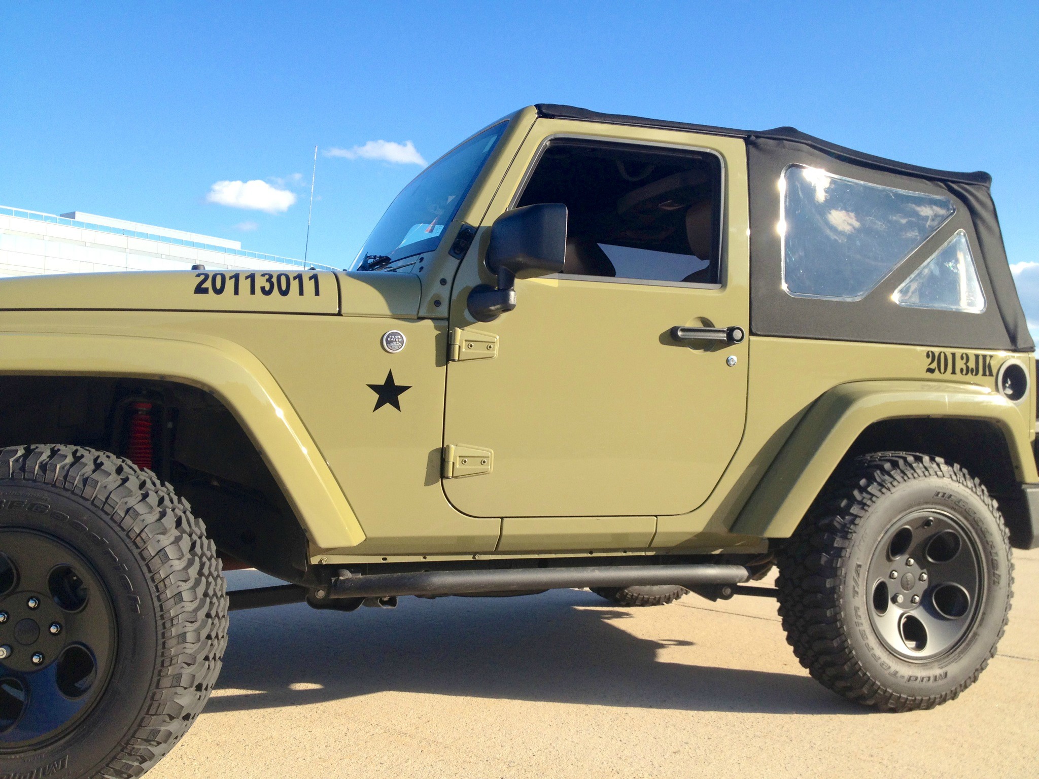

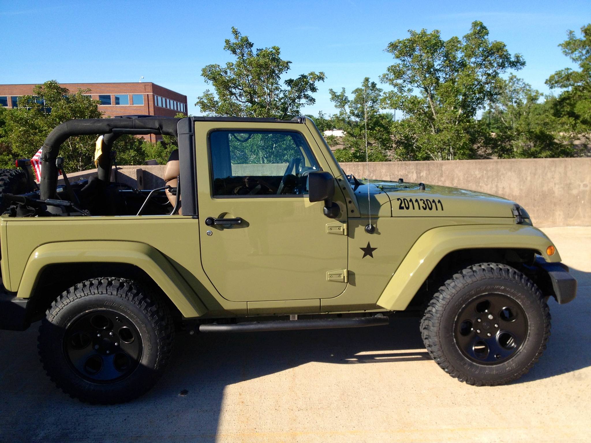

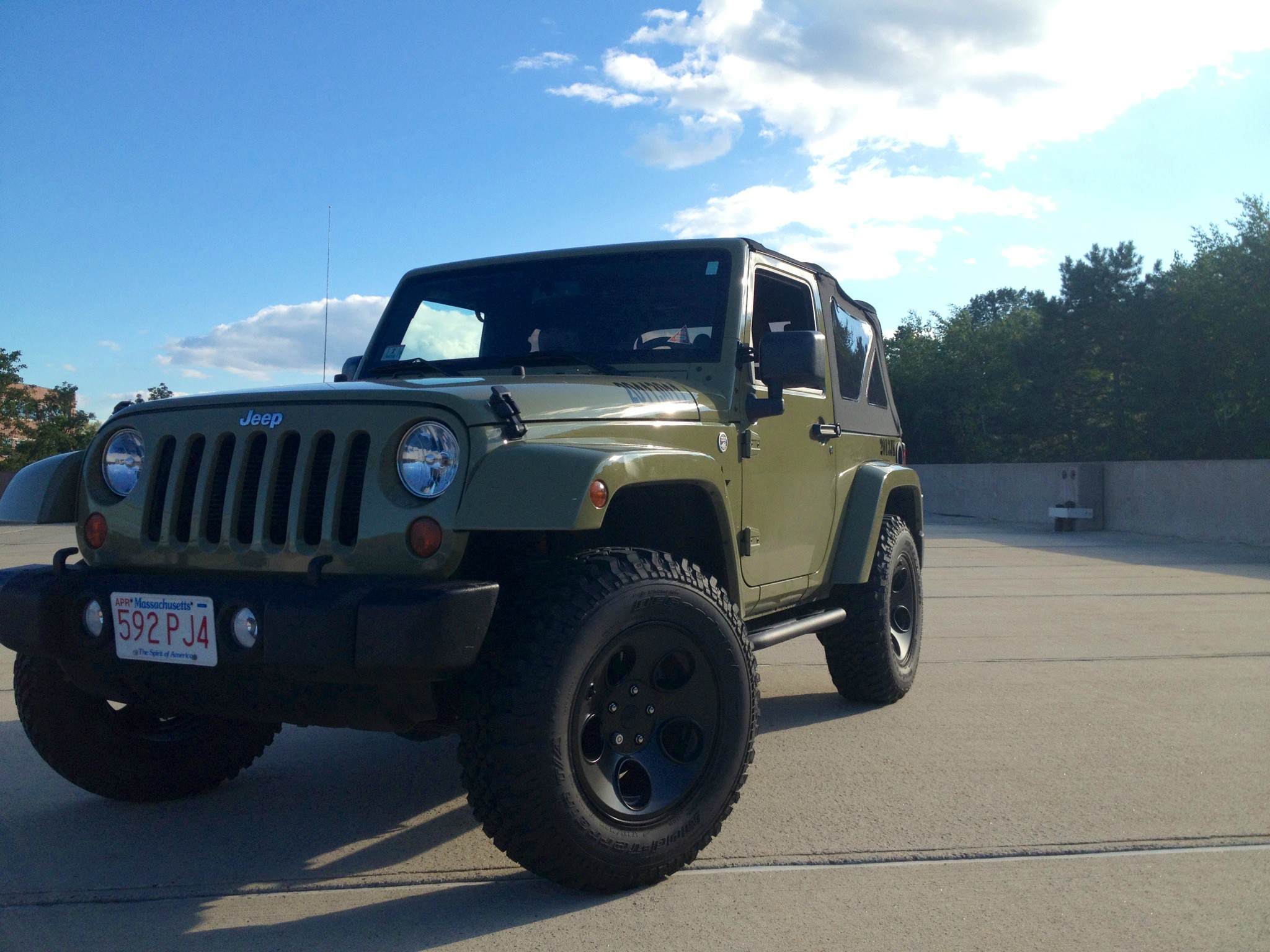

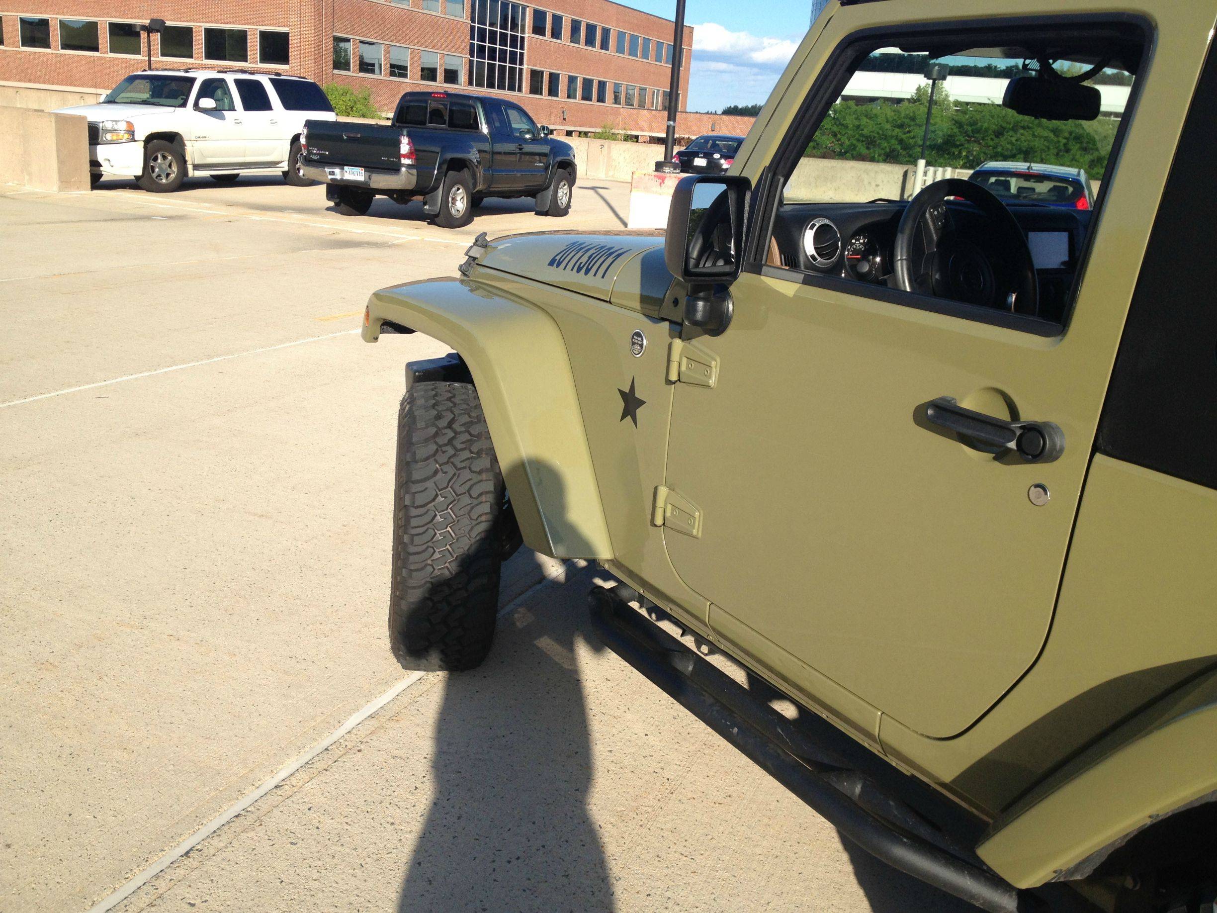

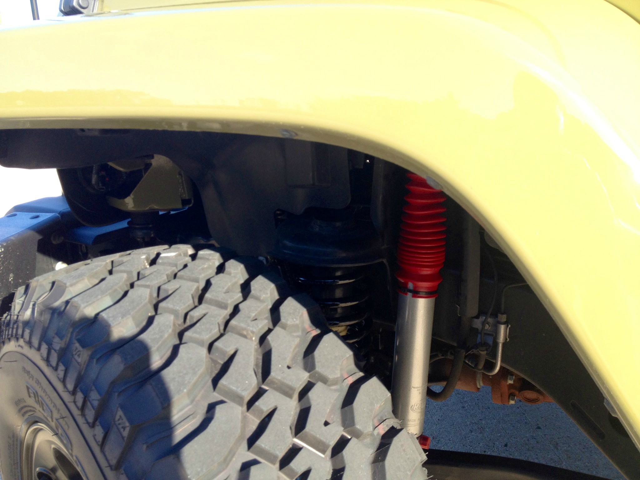

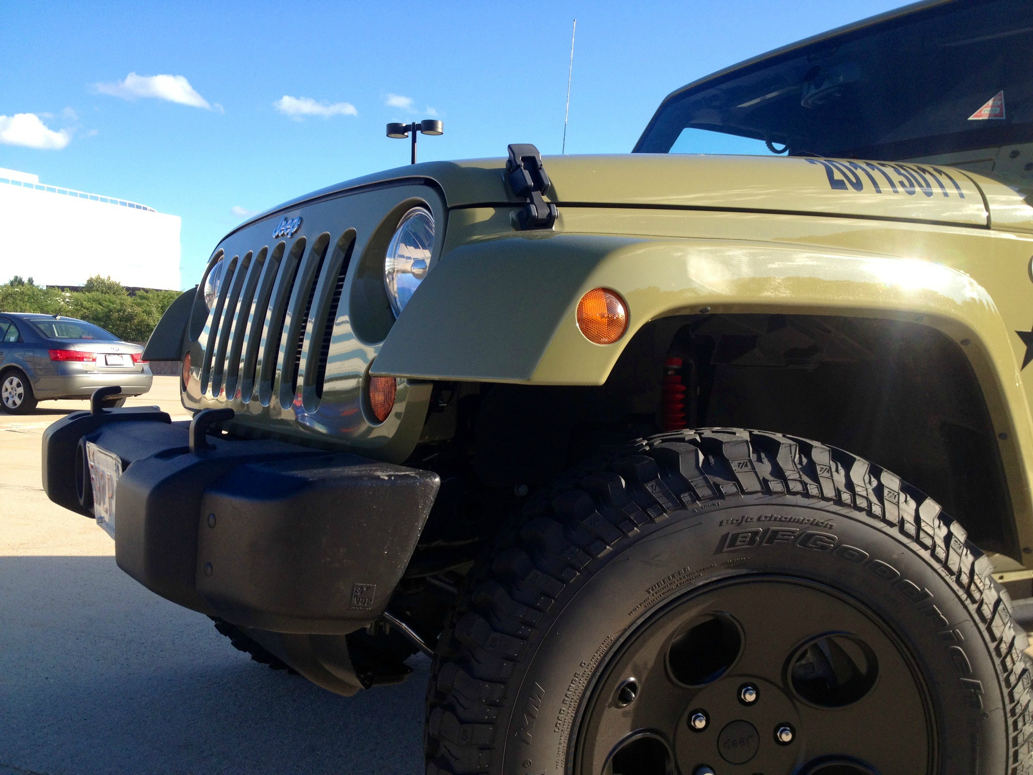

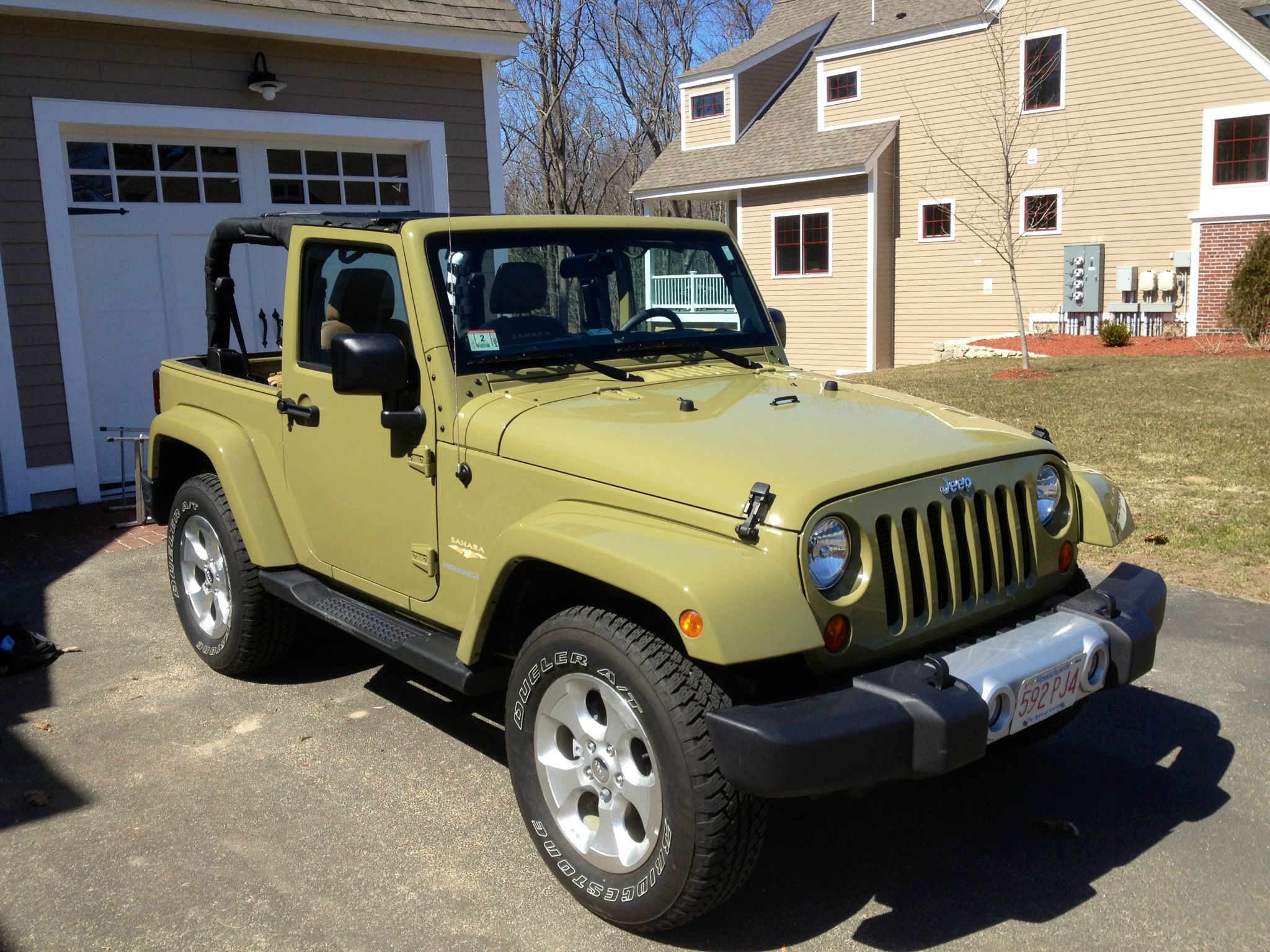

Here are pictures of my teraflex performance (coils) leveling kit and rancho rs9000xl shocks. Went through Eric Miles at Off Road Elements for parts, and BDR Automotive in Holliston, MA for install.
Before pics (stock wheels/tires, new wheels/tires):

After:

My tech said he thought the ride would be really rough, but it wasn't at all. It's just as smooth as the stock sahara/sport ride.

I just ordered the 1.5" kit but am a little concerned. It does not look like yours lifted much if any in the back. I have 60 springs already so hope I get at least 1" more in back. If you measure from the center bottom part of the rear flair to the ground what do you get? thanks

About 37 inches.
If you're concerned about getting a lot of lift, you should get a true lift kit like the OME 2 incher or AEV 2 incher. Or possibly throw pucks in the rear to compensate? I had 59s and I only notice a subtle difference in the back. I would guess I got a little less than an inch if I had to estimate or maybe exactly an inch. Definitely not more... I did have 14s in the front though, so that would explain why the front looks monstrousily bigger.
I wasn't going for a lift, just looking to give the JK a little bit more of an aggressive stance.
