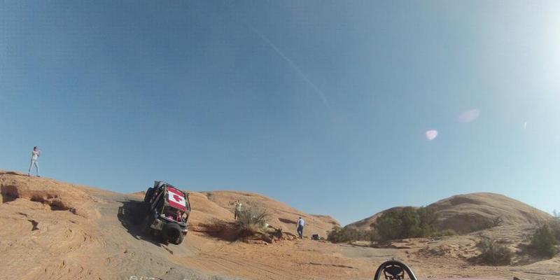

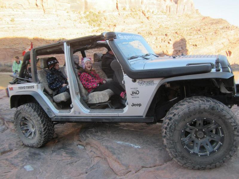

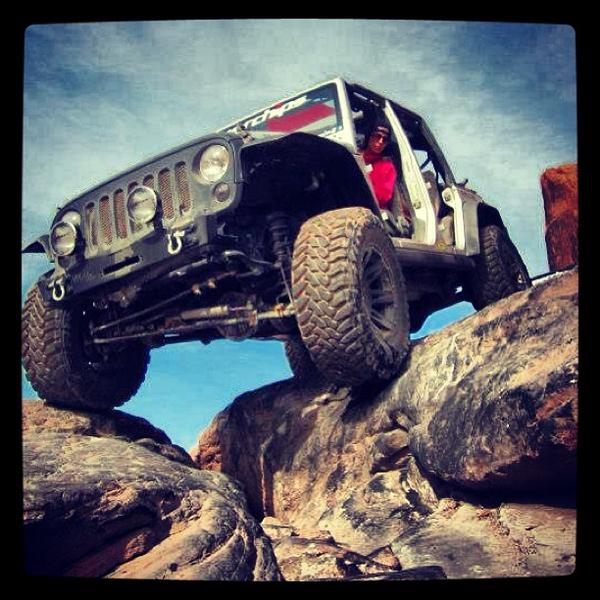

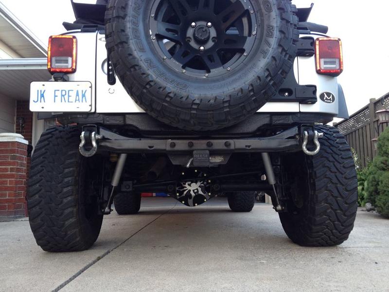

TF 2.5" BB and it rides awesome....my stock Rubi springs have not sagged at all and have taken me through all sorts of obstacles with zero issues.
