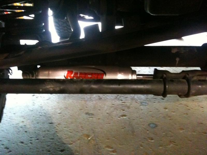

Mine only lasted 8 mo's blew a seal I went with a Rancho this time 3 weeks now... RS5000
