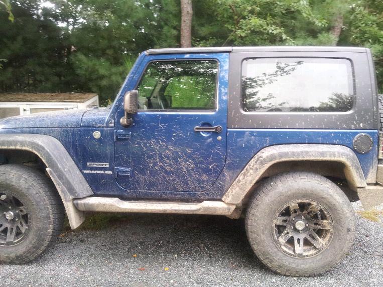

Old Sep 10, 2012 | 05:23 PM
blue project's Avatar
Posts: 1,531
From: Cape Cod
My tires are a 285/75/17 on a rugged d ridge wheel. So a 33.5" x 11.2" mounted tire with a wheel back spacing of 4.5".

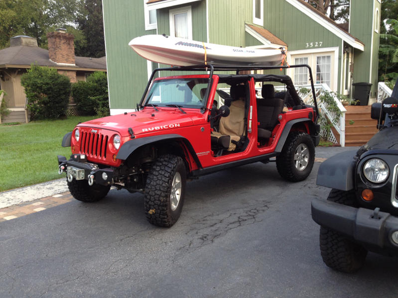

Old Sep 10, 2012 | 05:41 PM
SBEII's Avatar
Posts: 1,975
From: Myrtle Beach, SC
The spacers are more for the width. I'm running spacers with my 35x12.50s.
Old Sep 10, 2012 | 06:02 PM
aesop00019's Avatar
Posts: 32
From: Winnipeg, MB
Wow...you running 35's with just a 1.5 leveling kit? Don't you get any rub or having the flat fenders do the trick?
