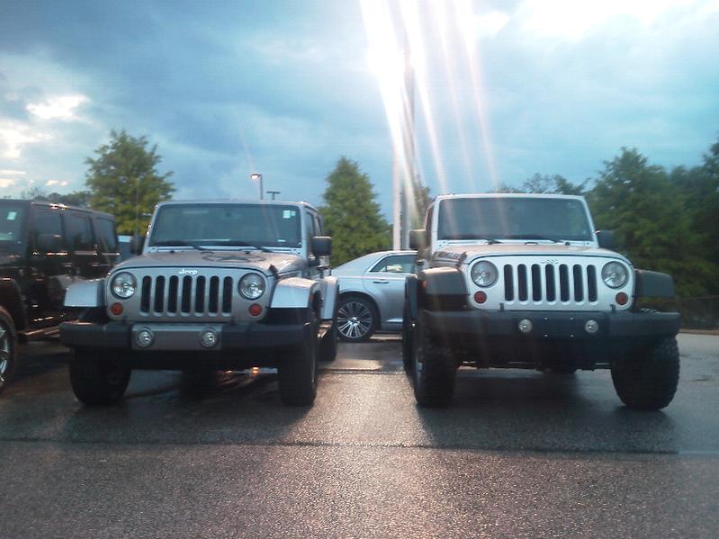

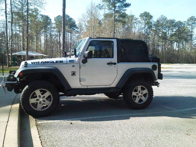

I went from 14/55 to 18/59's...and TF leveling kit. No track bar. Runs great and no issues.

Out of curiosity how much overall lift did you receive with that combination?

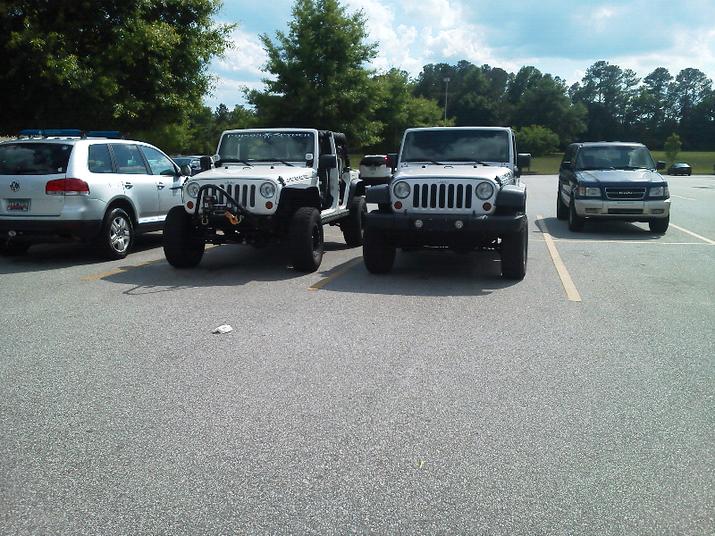

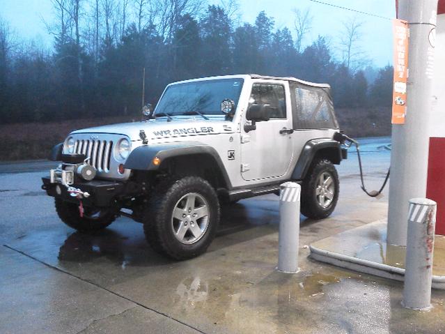

I would have to do a true measure, but I installed 2 pucks in front and 1 in rear. Wild guess maybe close to 3". I actually parked next to a guy with a 4 door sport. Do not know numbers of his springs, but he installed a TF BB and was running 285x70x17's I believe. Mine sat pretty close in height. I am running 255x75x17 BFG M/T's. If I had to dis-connect I can see getting longer brake lines. Other than that absolutely no problems at all. I have had this set up for probably close to 20-30,000 miles. No issues runs true. No "death wobble". I also added a winch and front bumper as well.
