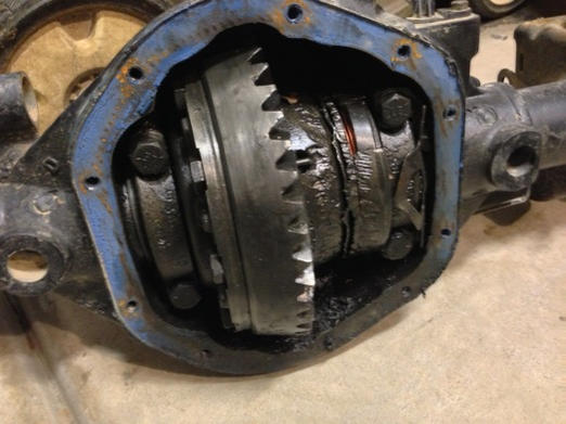

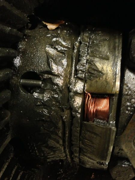

Here is what the locker looks like, which makes me think its not gonna work... But is it repairable?

Old Nov 28, 2012 | 03:08 PM
sick jk's Avatar
Posts: 1,740
From: Poway. San diego
That thing is gone!
Old Nov 28, 2012 | 03:12 PM
Hammerstien's Avatar
Posts: 784
From: North jersey
Yes you can hook a battery up to it but like the last guy said.... It's done
Old Nov 28, 2012 | 03:15 PM
ronjenx's Avatar
Posts: 12,907
Likes: 185
From: Maine
You're right. It's not gonna work.
But, if you were to test one, it would be as simple as connecting 12 volts to the two wires at the connector.
So far, no one has found a source for new replacement parts.
Old Nov 28, 2012 | 03:21 PM
Rockroaster's Avatar
Joined: Dec 2009
Posts: 1,057
From: Charlotte, NC
That's what I figured. Even still, I got a good deal on the housing, the locker working/repairable woulda been icing on the cake. Wonder if it would be worth trying to sell for parts....
