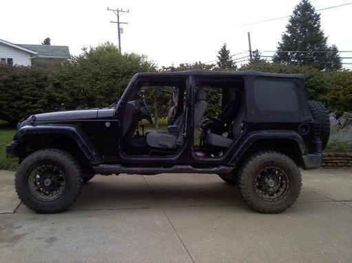

Front trackbar should be done
Front LCAs are a nice addition
I imagine you already have either the axle or frame mount trackbar bracket from the BB kit so you should be good there.
Front 3" TF Coils / Rear TF BB
