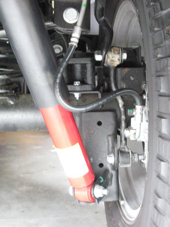

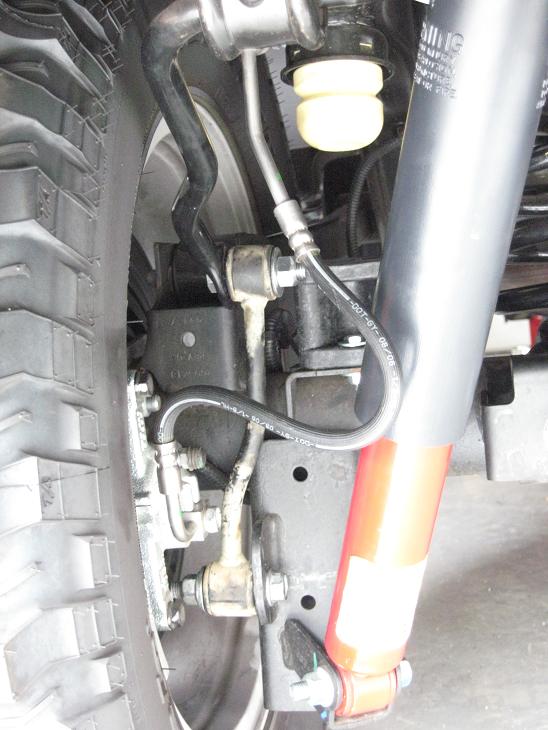

So I just went and measured them and looked again to see where they ended up.
The links that came with the kit were 4 inches longer than the originals (14 inches vs 10" orignal. This put the sway bar past horizontal - I had to go look rather than memory which made the sway bar rub on the tire.
I included pics of the WJ sway on there which fixed the problem.
We tried every imaginable setup for the kit links but there were many problems from them being that long, including the the top bolts looked like they would hit the frame before the bump stops as well as the above problem.
Right, but you just installed a 2.5" lift on your JK. That means they are only 1.5" longer than what they needed to be stock and this is totally within the acceptable range. Does this make sense?
What can I say, if the WJ links work for you, wonderful. And, if they are a bit short, by how much, +/- an inch is totally okay and you should be just fine. Hell, for whatever it's worth, my TFBB kit didn't come with new links and I just ran the factory links and without any problems I might add.
