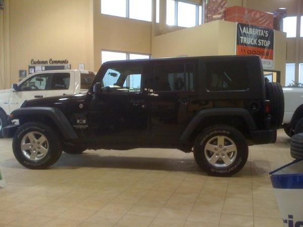

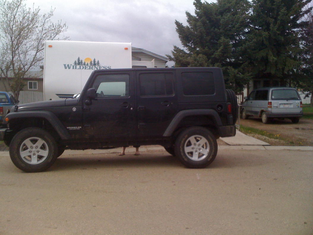

so i centered the rear axle with the rear trc bar bracket and moved my rear swaybar endlinks to the inside being i had them mounted to the ouside before. i have wheel spacers so that could account for why i had no rubbing issues but figured i better just do it anyway. heres the best before and after pics i got for now.
before

after

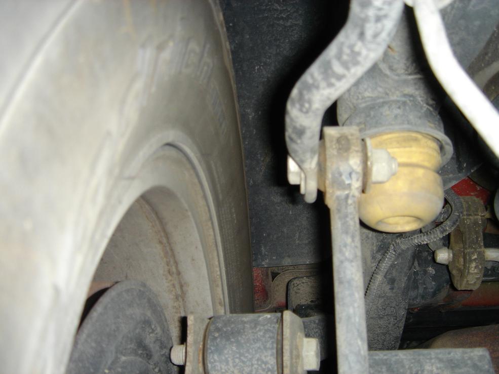

Originally Posted by BaloneyPony
Installed my today, and the rear sway bar upper link on the drivers side is jammed into the tire, pass side has lots of room.
Had to leave it disconnected and hanging down.
Ghey
connect your swaybar link on the other side should give you more clearance. Do both sidesClick image for larger version
