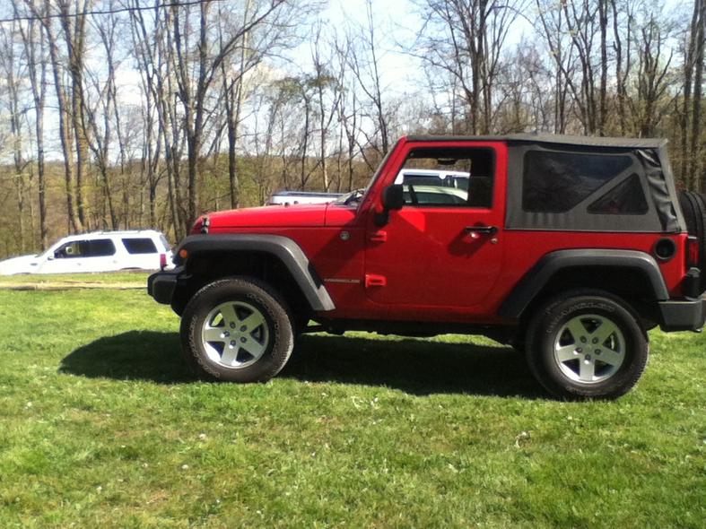

I ran a Rough Country 2.5" spacer lift on my previous jeep and I am currently running the AEV 2" spacer on my 2011. If I had not got a deal on the AEV through a fellow member I probably would have went for something a little less expensive. I have not noticed any ride or quality difference between the two. I have no personal experience with the teraflex leveling kit so I have no input on that one. The only difference I found between the rough country and the AEV was that the RC did not come with extended swaybars and bump stops. Here is a pic of my 2 door with the AEV pretty much stock otherwise:
