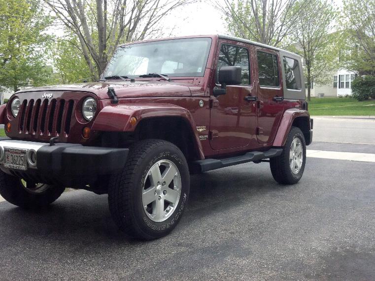

Took 3.5 hrs,4 beers but all went good.i have driven it for 1 1/2 days ,rides way better than stock.I am very happy with coil kit.i got about 2 " in front and 1 " in back out of lift.front is about 1/2" higher than level but when I put new winch bumper on it should be perfect.thanks teraflex for a great kit.

Heres pic ill send more after I get rims and tires on tuesday

Did you needs wheel spacers (if you used stock wheels)?

At kids soccer game will send more when I get home .ill take some with yape measure at wheel well

That's awesome! Looks good so far.
I'll be curious what it'll look like with your new wheels and tires, and specifically which sizes you went with. This is likely the way I'll go, unless I do the OME 2" HD coils... decisions!
Also curious if you considered staying with the stock wheels.
You will need spacers on stock wheels if you are increasing the tire width significantly, stock wheels need more back spacing. if you want to clear the suspension components with wider rubber they, or new wheels are a must.
