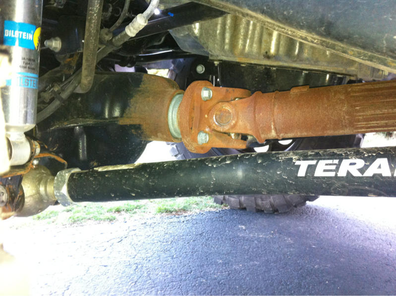

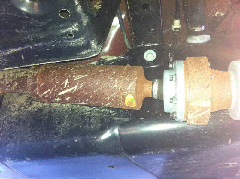

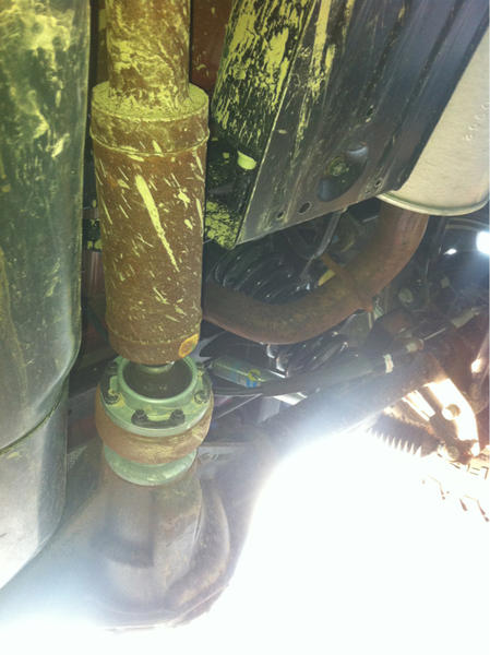

Here's some pics i snapped of the rear coming off the trans to the differential

And here's the front meeting the differential

The rear doesn't look to bad at all. Did u measure the angles with an angle finder? U want to measure the angle on the bottom of the diff by the pinion, and on the shaft. U want the diff a few degrees down from the shaft angle.. Ie if the shaft is 30 degrees, make the diff at around 27 degrees.
The front will look like that, otherwise u will have a really low caster setting and the jeep will wander alot when u drive.
Only way to lessen the angles is get aftermarket double Cardon driveshafts which are longer and will lessen the operating angle on the joints.
