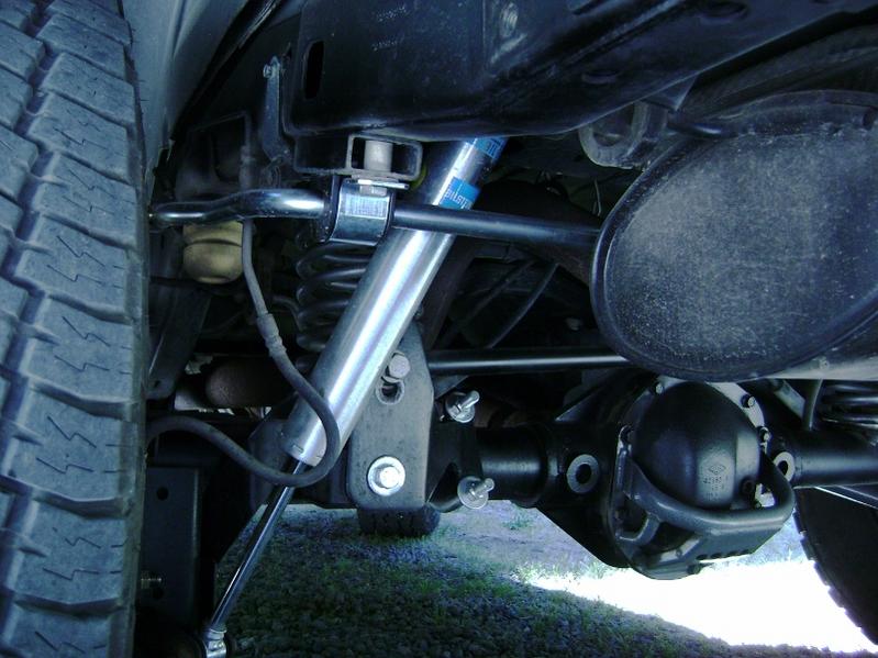

When I started with a 2.5 susp lift, my front axle did not need re aligning. If it drives straight, looks straight, probably all good. After lifting 3" susp, I had to add an adj track bar to re-aligne the axle almost a full .5". Pic is of TF rear tbar hd bracket, great for any lift to strengthen the weak stock bracket if your planning on flexxing. Also raises the rear track bar to give you a better roll center.

well then you're an exception. almost everybody, including myself with 2.5+ lift appreciated the ride much more when the axles were centered. if both axles are off center in the same direction, then i can see the jeep still driving straight, but i like all my geometry to be correct and on point. even when i went from the tf track bar bracket which was still off my 1/4 inch, to my adjustable track bar i was able to tell the difference on my daily commute of highway driving at 75-80mph. i noticed the most improvement when taking turns. but the bracket is good enough; better than nothing at all and it also helps beef up the track bar mount by connecting to the lca bolt for support. op- you be the judge, try it without the bracket, and if it drives like crap then get the bracket or new track bar.

All good points. I guess it comes down to personal preference. I wouldn't hesitate to put it on if so many people weren't saying the holes they drilled were not ligning up. I guess they've had to drill bigger holes and use different size bolts to accomodate? I'll give it a whirl and see what happens. Thanks gentleman..
