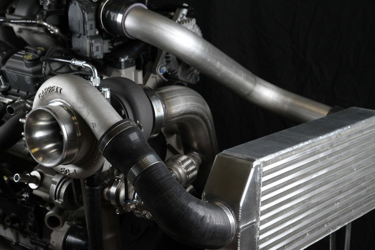

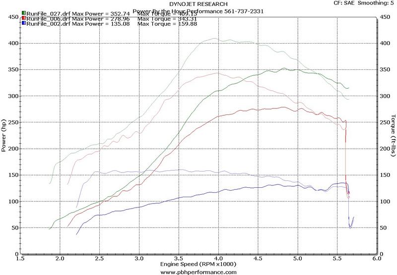

Make sure you are geared properly for your tire size. This should give you good performance at slower speeds (around town, city driving, etc), and good off-road performance.
If you're still not happy with performance at higher speeds (accelerating quickly up to speed, merging onto freeways, passing performance, maintaining speed up hills on the freeway, etc.), then the only thing that can help you is more power in the mid-to-upper RPM range.
We can help you with that
ID:	649385Click image for larger version
(dyno chart shows stock, Stage 2 turbo, and Stage 3 turbo; stage 3 is available for manual transmission only)
More than 100% gain (DOUBLE stock torque/power, DOUBLE the acceleration) from 3500 RPM up with our Stage 2 turbo.
Let me know if you have any questions.
~Jeff
