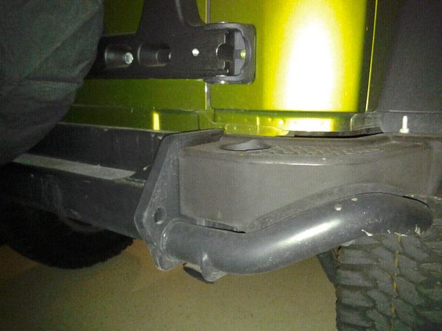

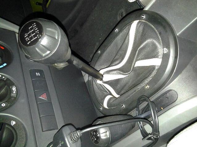

I put one on to cool my floor some since I removed my carpet. And with my 08 I didn't have to do anything extra to my 6 speed with a 1" daystar body lift. I know some you have to use a trans spacer
Old Oct 2, 2012 | 07:11 AM
DocFuller's Avatar
Posts: 200
From: Colorado Springs
I installed the performance accessories 1" BL and encountered zero problems. The space at the rear bumper isn't THAT bad, and I installed a leather shift boot from Redline to fix the stiff stock boot. Never had to trim inner boot to prevent popping out of gear- consider myself lucky, I guess.
