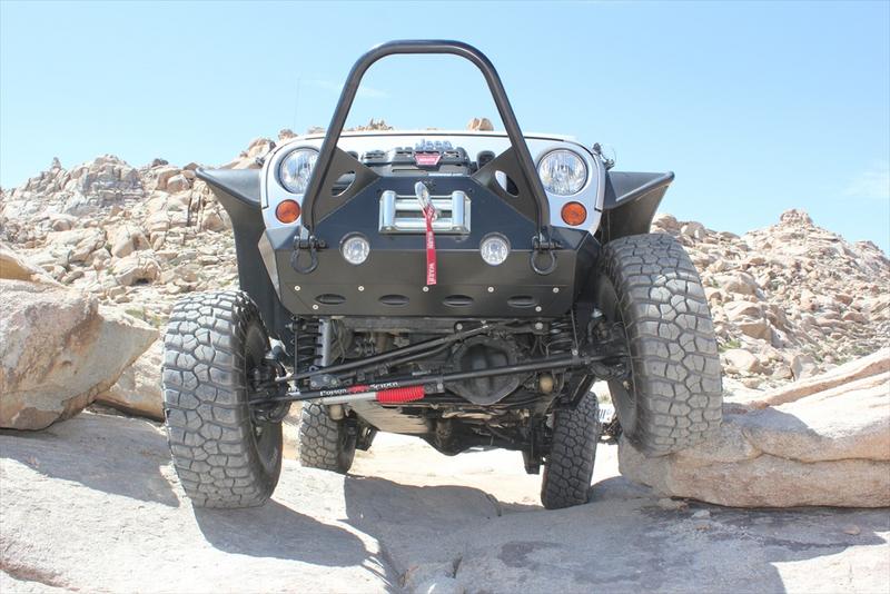

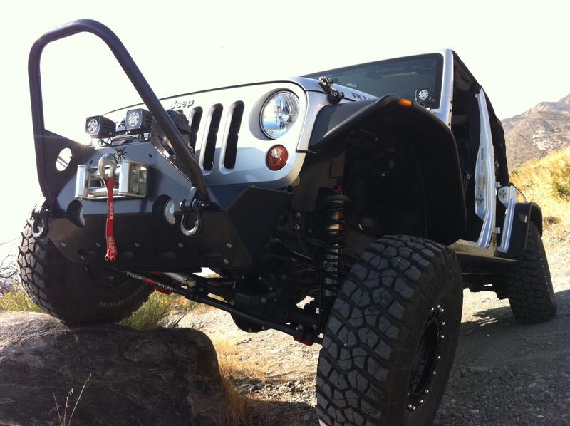

I run a 4" teraflex lift on 35's. I have done alot of the harder trails here in California , and I would say. Yes!!! you need all the items listed plus. I tried to get away without changing the driveshafts and first trip out I ripped the front boot and opened the trans pan. Front end steering issues also come with 4"lifts. If you don't use upper and lower control arms. Trackbars are a must for centering the axles and alignment. I have also upgraded to currie correct steer kit and JKS sector shaft brace. This eliminated the wander often found with 4" lifts. Click image for larger version
ID:	412845 Click image for larger version

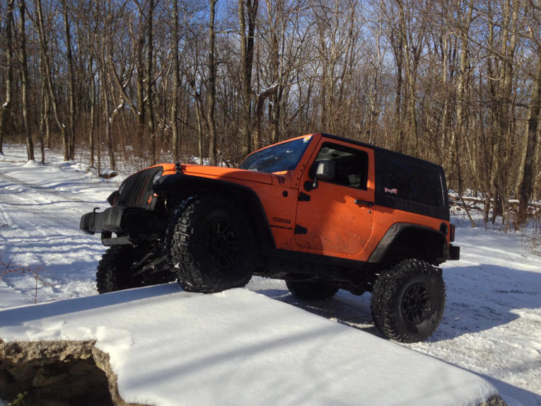

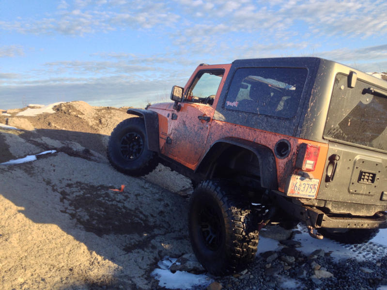

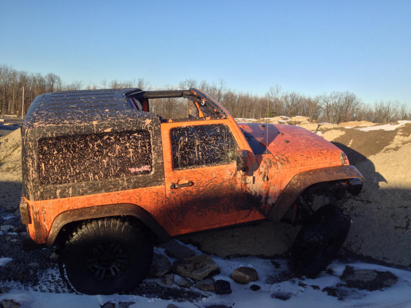

Just so you know, I'm running 35" BFG km2's which are like .25" bigger, and all I have is a teraflex 2.5" budget boost and cut fenders, and zero rubbing. Rides great, and if I trim my pinch seam I could probably run 37's if I wanted to...just an FYI
