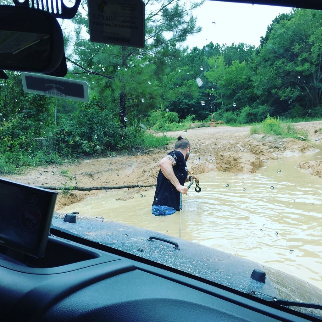

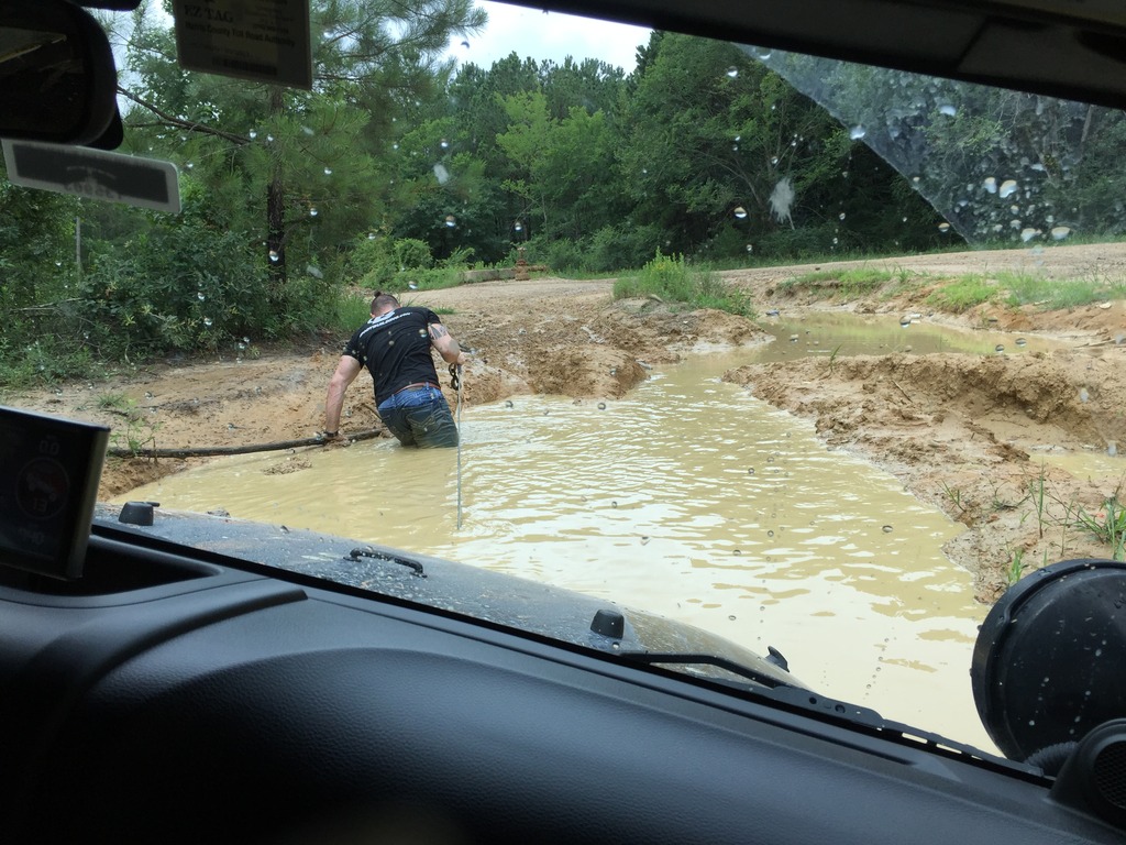

Finally took my new-ish to me '11 Rubi (35", 2.5 lift - only 18k miles :-) ) out a few weeks back to Creekside over in Splendora. It was all fun and games - shallow holes, mostly playing around, until I got into a big hole. I went in slow and all seemed good, so i got on it a little bit. Then it dropped off and I high centered. I was angled to the passenger side and the water was above the door line and coming into the passenger side. All good. Hopped out to hook up the winch, which tensioned up and then promptly failed. Luckily another Jeep came along and helped me out. Lesson learned - stop wheeling alone. Anybody in the Conroe area that wheels a lot?

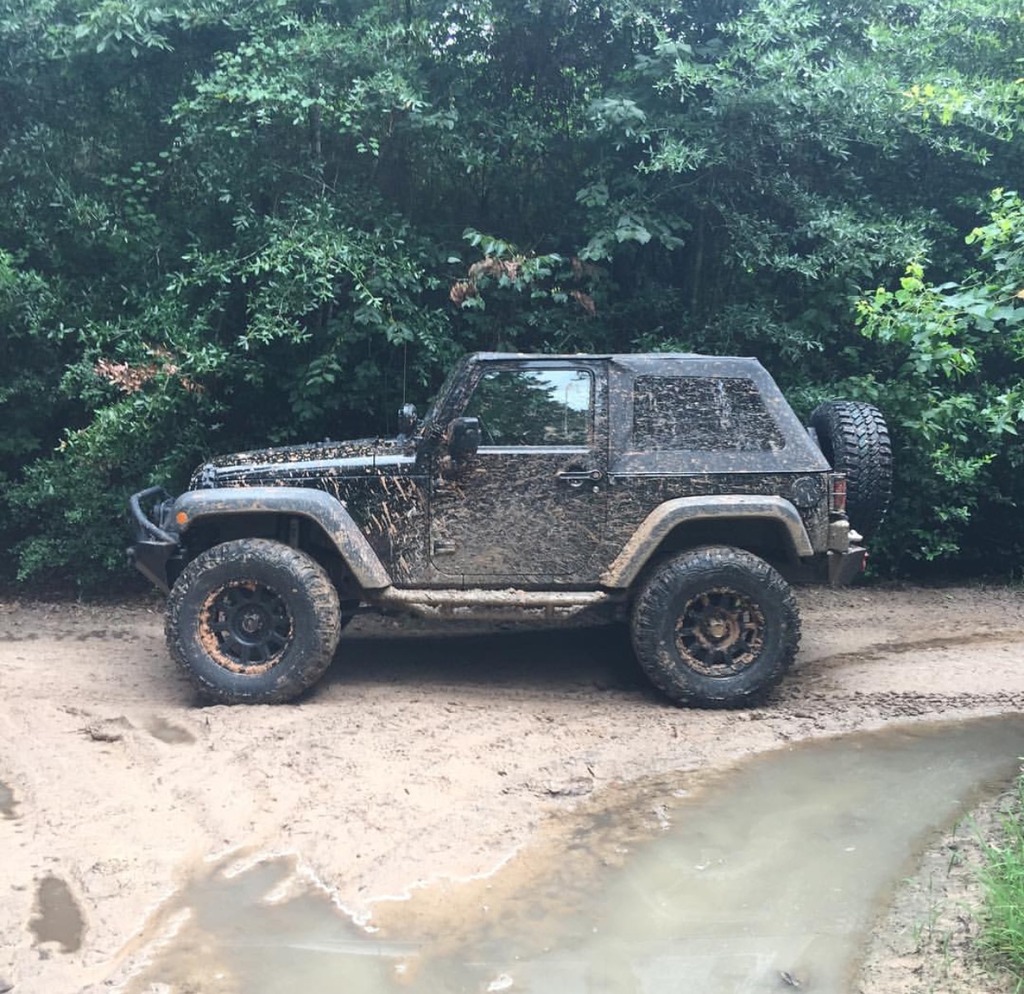

Here's some pictures of my dumbass moment and a nice shot of the rig
