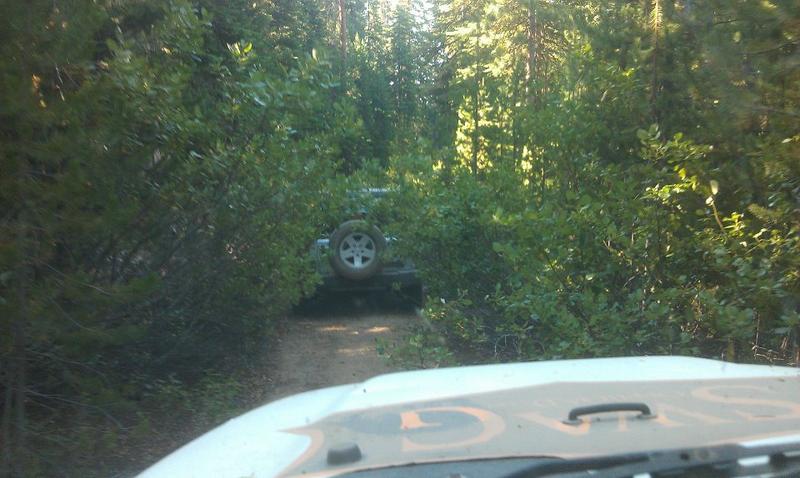

Paint it Silver. That's the route i'm going just as soon as I get my floor linexed. I plan on painting mine Silver and line xing the inside of the hard top and panels as well, plus doing the head liners.
After owning my Jeep for three weeks and going on a trip where ten straight miles of the 800 mi. trip was this...
I decided that I want the benefits and looks of a matching Silver top.

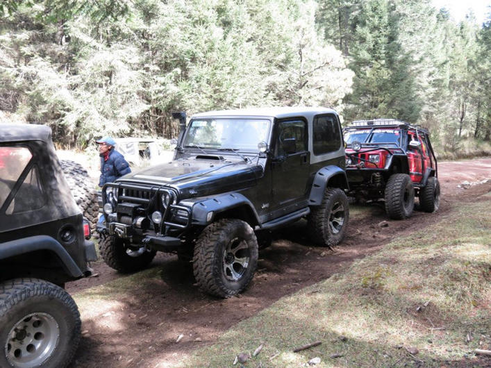

do it,will help a lot with the sun heat, a guy in my club did it to is tj and its hardw r to see the scratches
another guy from office with a silver jku 07 did it and looks good... but he does not wheel it, the camo idea is also nice, i was thinking going that way using some vinyl sheets

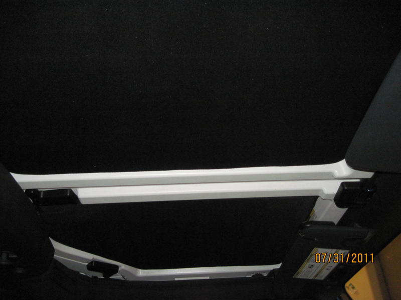

I bought some reflective foil insulation, foam insulated board and 3M headliner adhesive from Lowe's, I bought some headliner material from a local automotive upholstrey shop and some 3M automotive trim double sided tape from Auto Zone, I think it was all around $100. The reflective foil goes on top of the foam board and the headliner material on the bottom, it's all glued together. The 3M tape was used to hold it to the top and I haven't had any issues with it sagging, even though last summer was a record for the number of 100 degree days. It ended up being about 3/4 of an inch thick, but the materials are very light.
It was probably one of the best projects I have done when it comes to comfort. Now the A/C can be run at half the blower speed when it's that hot out and it maintains a cool temperature inside instead of struggling at full blast before the insulation. It also seems to help with sound deadening and it doesnt sound like your talking in a can.
