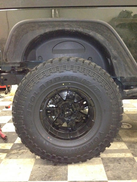

The 8 short control arm setup is different in the rear than when a person just buys a set of control arms
They are 1 inch longer so if you already have a set make sure they are long enough because when you start going upwards you really gotta lengthen to recenter the rear axle
