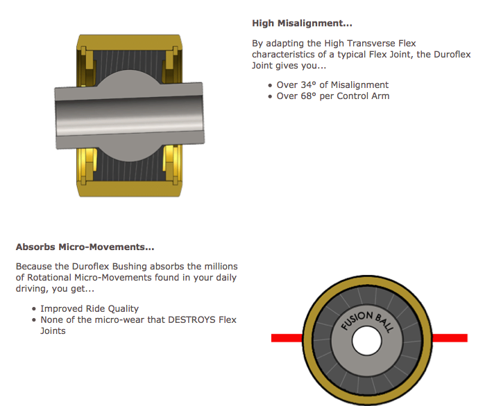

Per Metalcloak's website, their control arm bushings only account for high misalignment / "transverse flex" which is the up/down movement of the joint via up/down movement of the axle and the forward/back rotational movement of the joint which per their statement is the "micro-wear that DESTROYS flex joints."
Straight from the MetalCloak page...
Name:	Screen Shot 2016-12-24 at 4.32.38 AM.png
Side to side movement of the axle would equate to a side to side or "in and out" movement of the control arm bushings which no mfg, including Metalcloak, addresses on their website.
...and I have Synergy, MetalCloak, and JKS products on my rig so I'm not particular to one mfg.

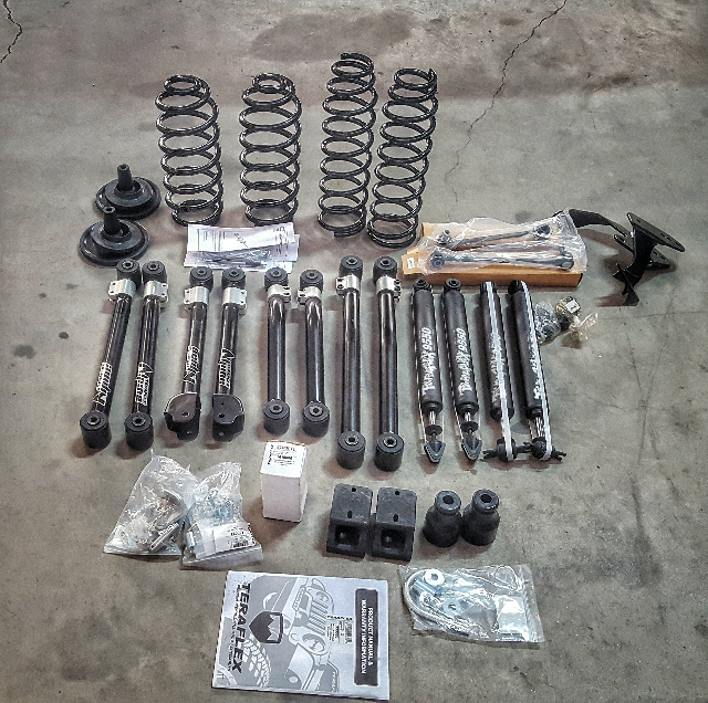

I'm currently running all 8 Teraflex Alpine Flexarms.....they are almost maintenance free you just need to ensure the locking collars haven't loosened. I love my 3" Teraflex Lift I'm also running there monster track bar, tierod and drag link.....not to mention their big rotor kit! Teraflex is a great company that stands behind there products.

Those locking collars look nice.
If/when I ever add or replace control arms (Rock Krawler today) I will get something like that. The RK stuff is awesome but Jam nuts are ridiculous.
Attachment 663383
In MetalCloak's defense, in their video they do show side-to-side movement of the control arm joint which most likely represents side-to-side movement of the axle as the axle shifts under extreme articulation which is good for crawling. The only problem is that the majority of the additional stress now gets focused on the 2 trackbar mounting points and/or the 2 trackbar bushings per axle.
Since most have a beefed up axle trackbar bracket that they have installed with their bolt-on lift kits, that means the thin frame side trackbar bracket is seeing the brunt of the flex stress = No bueno.
By keeping all of the bushings OEM/OEM-like, you can still evenly distribute the stress amongst all of the axle and frame side *control arm* mounting points as well as the trackbar mounting points vs having it all come down to 1 or 2 weakest links, in this case the front or rear trackbar mounting brackets.

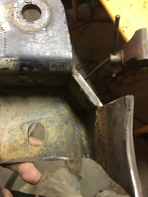

here's a RK trackbar I had rip off and just fixed
Damn. There you have it....
If you just take the rear axle / rear frame for example, OEM/OEM-like bushings you more evenly distribute stress amongst 4 control arm bracket mounting points and 2 trackbar mounting points = 6 points total.
If you install control arm joints with too much give, then essentially you're directing all of that additional stress to the 2 trackbar mounting points.
Stress distributed more evenly across 6 points (control arm + trackbar) vs. 2 points (trackbar only).......
I'll take the 6 points. If I have a choice of losing 1 control arm or the trackbar as a result of a snapped bracket, I'll opt for losing the control arm.
I'm curious about this. What size bolt do you (did you) have in the RK bar? Was it torqued properly to 125ft/lbs? I can see this damage happening if the bar was banging back and forth putting stresses on the brackets they were not designed for.
